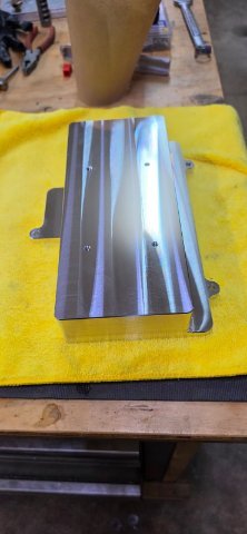

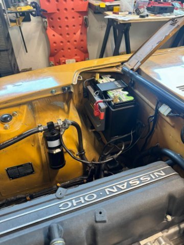

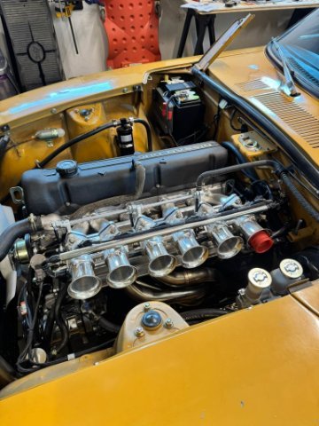

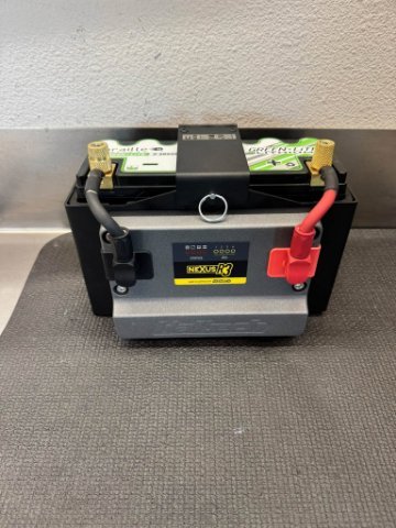

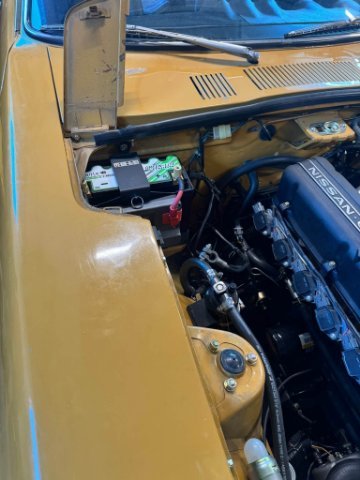

Why would I put my Haltech R3 in my engine bay? Well I’m doing the opposite of most people and going with my ecu in my engine bay. My 240z has dealer AC (it’s huge) and I hate having my ecu on my passenger kick panel. I have so little room there and I currently have a 5v short I cannot find. My harness is a mess from multiple ecu changes and wiring changes and it’s time to start over. The R3 is a 4 channel PDM with an internal 150amp fuse. So it can power my injectors, coils and fuel pump and leave me with 1-2 extra circuits for later down the line. Having it here will allow me to make a sexy harness that is fully serviceable and the whole thing will basically drop in. The mount will be getting cnc cut this week. The goal is a no holes drilled mount and no holes drilled in my car install, using a Braille battery. It will attach with dual J/V bolts.
