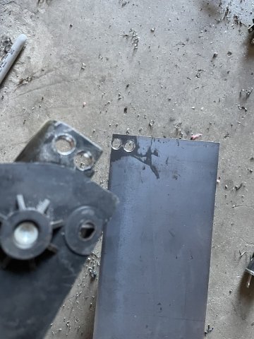

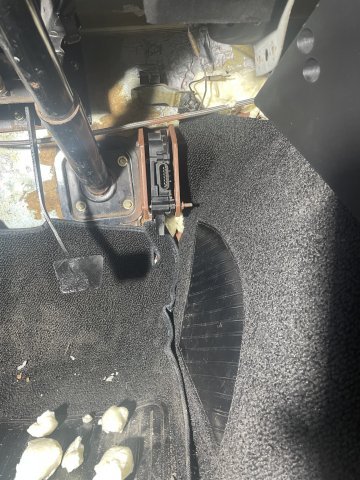

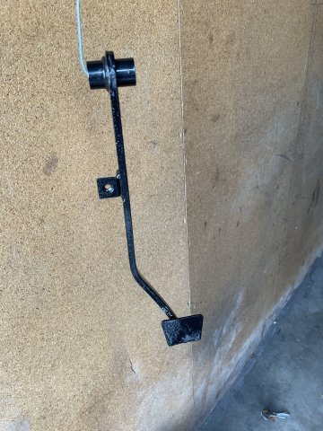

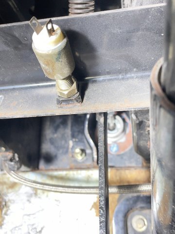

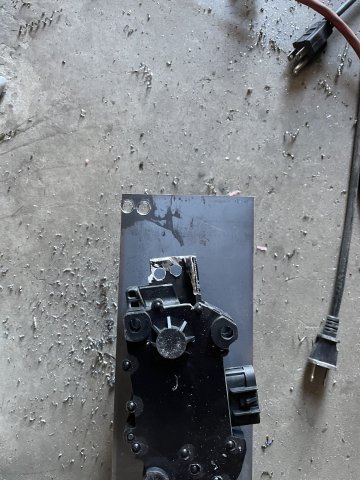

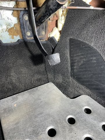

05-17-2026 ATLAS Z UPDATE: Short day in the garage, I went ahead and pulled the pedal and swapped in the correct one that had dried overnight from painting. I made sure to lube the bushing end with white grease and installed. it took a few tries, but I was able to make the push rod just the right length. Then I went ahead and wire wheeled up the clutch pedal, got it all cleaned up and painted it. I then took some time and got the bracket I made for the throttle by wire gas pedal for my engine/ECU setup from GM installed. I found that I had to cut the pedal shaft and drill it so that I can custom fab up a pedal rod that will clear everything and work right. After I made the mods to the pedal assy, I painted it and then isntalled it. A bit of work left to do in this area now, but got to a real good stopping point. PICS.
