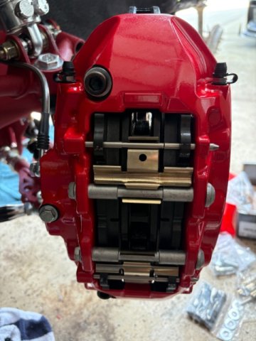

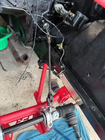

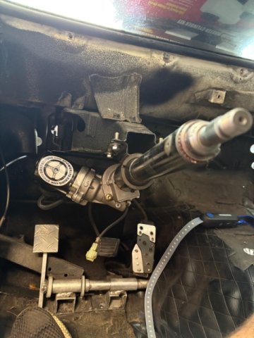

Got the electric power steering installed. You have to the-use original shaft that ties into the steering rack, was a huge PIA to get out of the upper universal joint and into the new one. Got brake pads in, ordered some brake fluid. - Today
