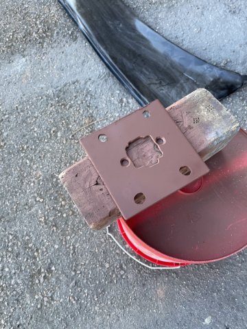

02-04-2026 more work on the ATLAS Z. I got the adaptor plate for the brake master done, more progress on the fuel cell, and unpacked some stuff. Pics follow:

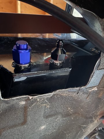

01-31-2026 UPDATE: I cut and modded the rear taillight panel and fitted some new reproduction euro style 240Z taillights and some factory covers I bought a while back that I had powdercoated gloss black. After that I attached the second hatch shock by drilling and tapping for it and then attached the MSA fiberglass rear spoiler. Then I cut the hole needed to access the fuel line hookups on the Evil Energy 10 gallon fuel cell. I turned it 90 degrees, as there wasn't enough rwork room underneath to have it facing back, and its much better as I now have a ton of room under there for setting up my whole fuel pump and filters setup. Then I wired the back half of the car, I will go back and make up the connections on the end later. I rustoleum primed the areas in the spare tire well and floors that needed it and then filed out the remaining holes on my dash center section so the gauges would sit in it the way I wanted them to. The rear taillight surround was the item that really fought me today. In particular the center section for the license plate. I ended up having to spend quite a bit of time modding it to make it look the way I wanted it to. The fuel cell isn't completely level yet as my 3/8" All Thread hasn't arrived yet. The all thread will attach at the feet on he bottom of the fuel cell and the bottom of the spare tire well. then at the top I have some 3/16" thick steel plates I will drill holes in for the all thread to level the tank up and drill holes to attach it through the floor on the ends. Pics follow.

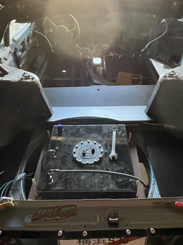

That type of fuel cell is only good for drag racing and mild street driving. I had something similar in my car when I first built it. When I started auto crossing the car, I found that the fuel had to be kept almost full to prevent starvation during braking and cornering.
10 gallon fuel cell from evil energy arrived. it fits! very nice quality. Last pic is from the Skillard site, but I just bought this floor and will be using it with this fuel cell and a battery box.
