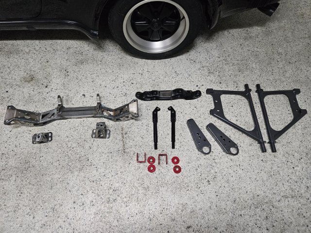

I was reminded earlier today about this thread and figured I'd post a quick update. Shell restoration has been moving along and I've been pinging the restoration shop for monthly updates. I just about finished reinforcement/welding on various suspension components so I'd like to get those powdercoated in a chassis/satin black. Fuel system has been completed and placed in storage. Waiting for some parts back from the machine shop for the oil system before I fabricate and weld on that. Busy with other projects too but several irons in the fire to restore my Z.
