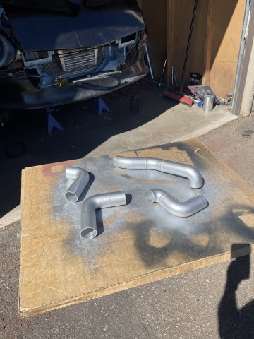

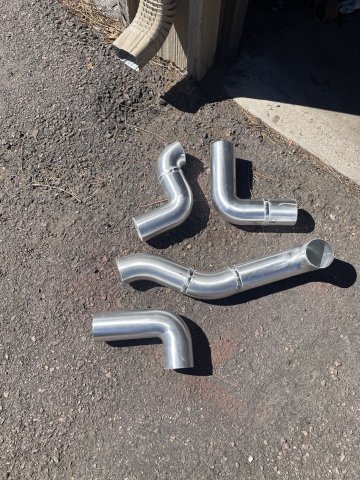

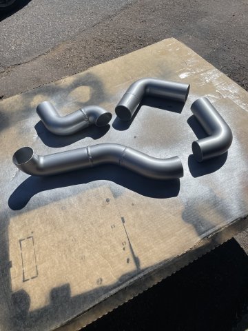

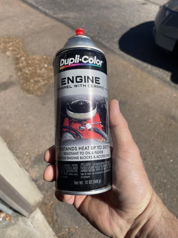

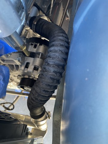

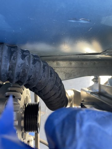

02-20-2026 ATLAS Z UPDATE: Today I got my intercooled pipes back from being welded up, and I decided to see how they would look painted. I used the Duplicolor silver engine block paint. I also was able to finally get the right length of hose for the lower radiator hookup. When time comes, I will tighten it up and assemble the intercooler piping! PICS.
