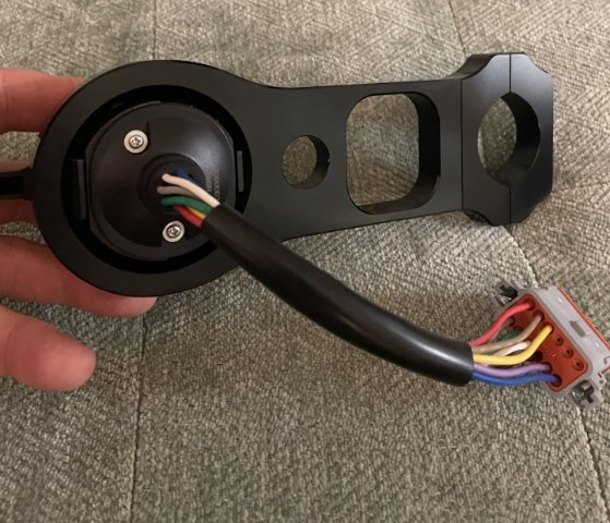

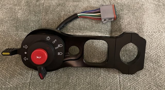

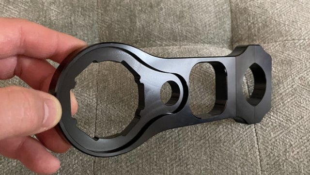

- Today
I got my billet column adaptor for my raceware turn signal lighting and horn control. Not too shabby.
