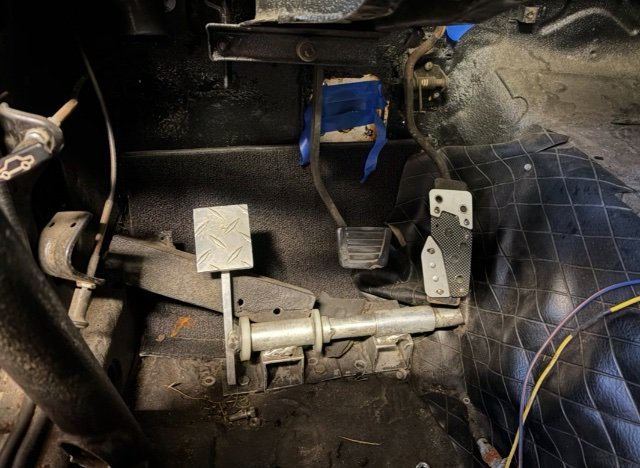

Got a few goodies today, first I found a cool bracket that can allow me to use a hydraulic set up for the clutch, it’ll let me get rid of the weird mechanical set up someone rigged up. Second was an impulse buy, while getting the turn signal/light switch and relay they had this emergency power stop button and solenoid. -
