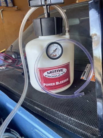

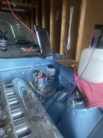

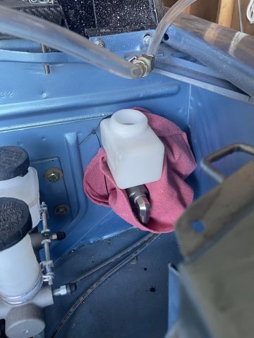

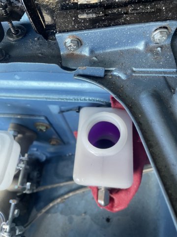

10-11-2026 ATLAS Z UPDATE. CLUTCH AND BRAKE BLEEDING. So, I drug out my Motive Power Bleeder, and hooked it all up and filled it with DOT 5 fluid to "charge" the new brake system, which is all dry. I started with the clutch, which went VERY fast, and It's crazy how stiff the clutch pressure plate is! Then I went to the brakes. It's pretty involved when everything is new, and compeltely dry. So, after playing around for quite a while with it, I then settled on doing it all one step at a time......a bled the master cylinder out with it's drains, both cylinders, then started the process....using the 15 psi, I was able to get the rear brakes bled out, and the passenger front wheel.....but then found the driver's front wouldnt drain unless I pumped the brake pedal AND used the pressure, so something is wrong. I can push the pedal to the floor. not completely dead, pedaled but still...... After getting chat GPT to help me, I went through the line from the brake caliper back step by step and found that no fluid was coming out of the factory port. So, I will have to get a T fitting and go off the port for the passenger front wheel and then it will be like the rear brakes are, both off the rear brake port. VERY close, but challenging. Dot 5, I love the stuff.....it doesn't eat paint, doesn't hold water like dot 3 or 4 does, and for regular street driving will work fine. PICS:
