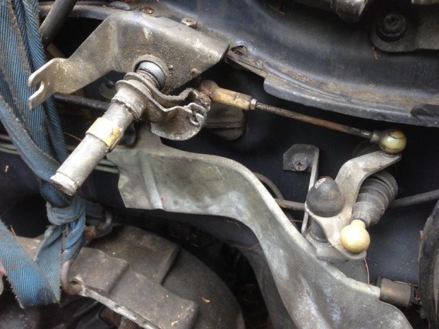

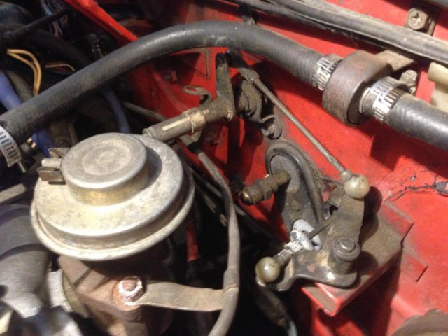

The J hook does interchange and the linkage between the bell cranks measures and looks interchangeable. The bell cranks are different though.
