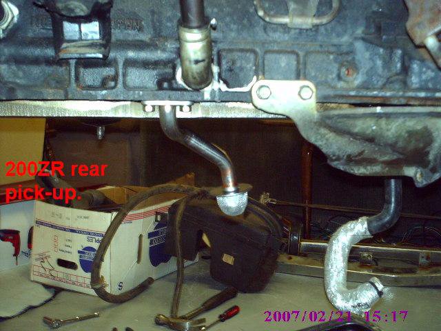

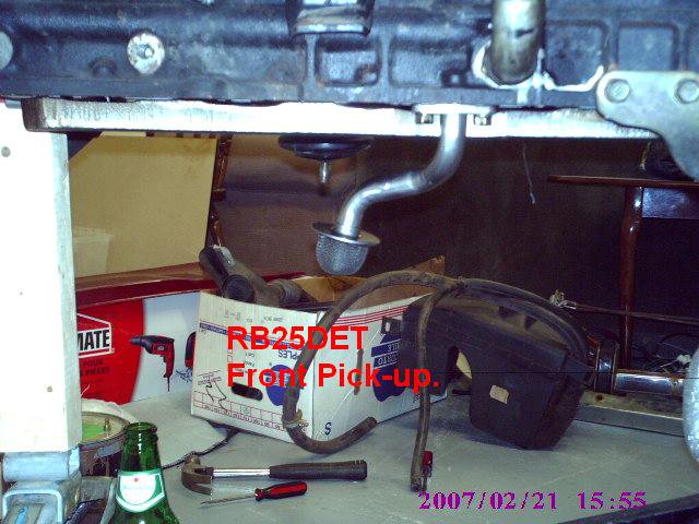

  4. From what I know, (Don't have an RB26 so, never took a close look into those) the windage tray inside the pan needs to be modified to fit the RB26 block. If you say that the pan is already modified, you should be OK. One thing to note is... the RB26 block has the oil pick up in the front instead of in the middle, like the RB20-25-30 blocks so, you need to modify your oil pickup to reach the rear bowl.

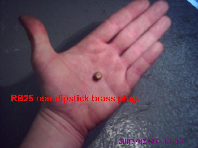

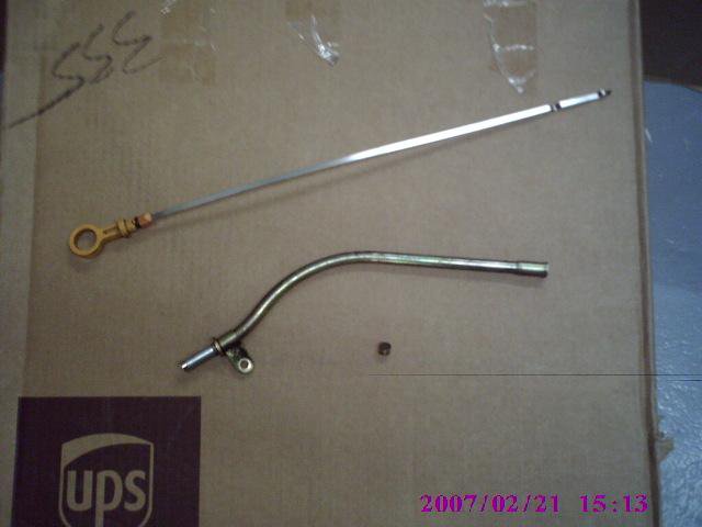

  8. Here's some more... Pics. 1- Dipstick, tube and rear "blank" hole brass plug. (R32-33-34, RB20-25-30 Vs. Z31 200ZR RB20DET) 2- Rear "blank" hole brass plug. You hammer this one out with a punch from underneath and reuse it to plug the, now open, front dipstick hole. (R32-33-34, RB20-25-30 + 26 Vs. Z31 200ZR RB20DET) 3- Relocated dipstick. (R32-33-34, RB20-25-30 + 26 Vs. Z31 200ZR RB20DET) 4- Front pickup. (R32-33-34, RB20-25-30) 5- Rear pickup. (Z31 200ZR RB20DET)

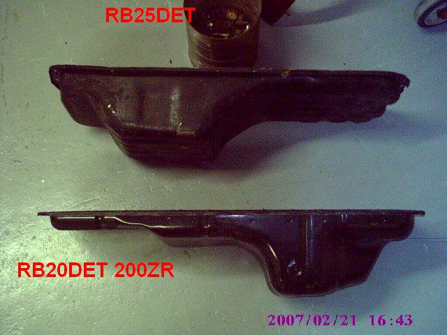

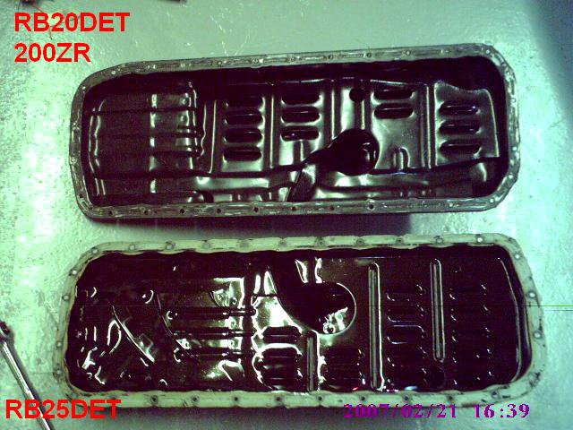

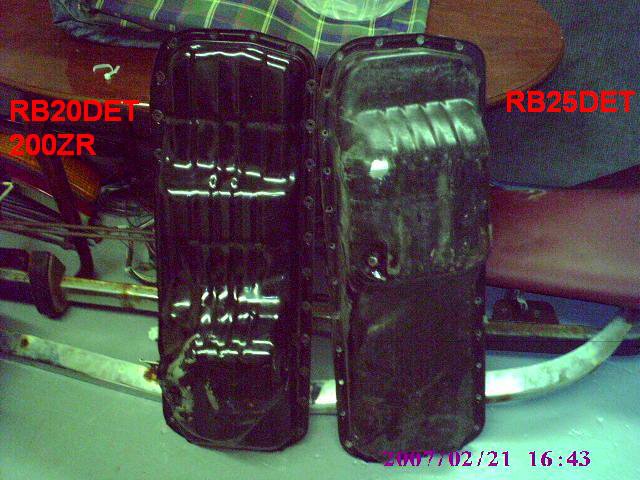

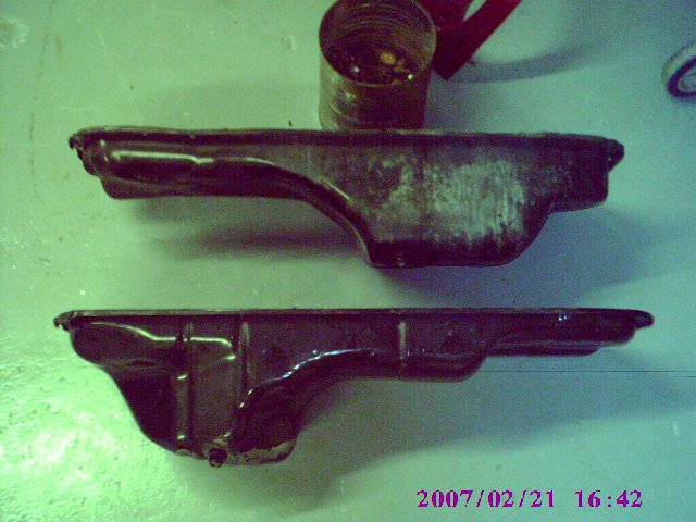

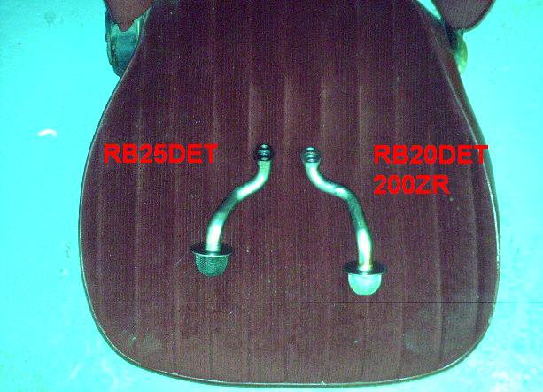

  11. Hi, just took pics of my new oil pick-up, I'll post pics of the pans side by side when I get them. Pics: 1- both oil pick ups. (R32-33-34, RB20-25-30 Vs. Z31 200ZR RB20DET) 2-Both oil pans from the drain plug side. (R32-33-34, RB20-25-30 Vs. Z31 200ZR RB20DET) 3-Both oil pans from the turbo drain side. (R32-33-34, RB20-25-30 Vs. Z31 200ZR RB20DET) 4-Both pans from the bottom. (R32-33-34, RB20-25-30 Vs. Z31 200ZR RB20DET) 5-Both pans from inside. (R32-33-34, RB20-25-30 Vs. Z31 200ZR RB20DET)

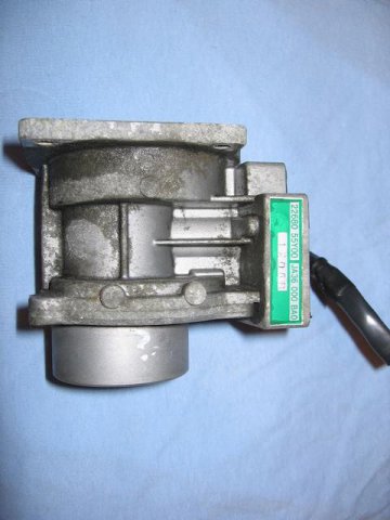

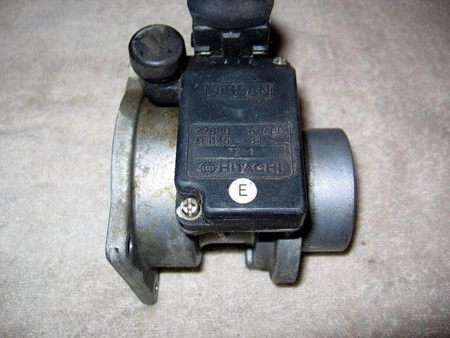

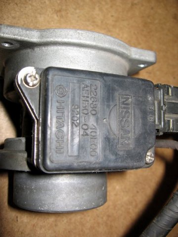

  16. Here's the rest of the MAF pics. 6 trough 9.
