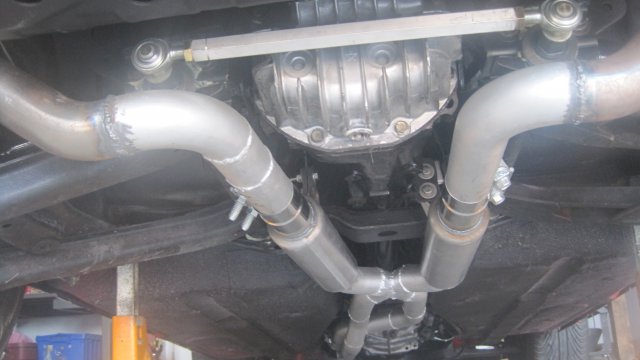

Well i thought I had tamed the wild beast, but I had to do some additional work. The resonance at 2500 was still really loud, so I ordered some resonators and slapped them in-quite easy infact. Now I getting to the place I want to be. I think the car sounds amazing. The resonance is now doable with just some slight crackling around that magic number 2500. I am still in the break-in period on the engine, so 4000 is about all i'm doing for now. I could cruise around all day at 3200 because it sounds so sweet. 3200 in 5th will be about 75-80mph so highway speeds will be a pleasure. It sounds very beafy at low end and starts to scream as I climb the rpms. I will try to make a recording if I can capture the sound well enough. If I had some exhaust tip resonators I imagine it would be perfect for me, but it will get me to Zcon in style for now.

) I kind of let this thread go by the wayside, but progress has been made. I finally got to hear my exhaust run last week and all I can say is--TOO LOUD guess I should have figured that 12$ glasspacks wouldn't do much, but combine that with headers and it's too much for this old man. The magna flow mufflers have already been ordered and delivered and hopefully will tame the wild beast. I will get out of the highway and have a little fun with the 'race car" before I change the mufflers over Enjoy some pics and sound video http://s2.photobucket.com/albums/y9/_mad_kaw_/z%20exhaust/?action=view¤t=Zcar001.flv

Did you watch the video, how does your exhaust compare to mine as far as volume? Do you have a header on your car? Do you have any resonators on the pipes?
Yeh I'd like to hear it revved up myself but that motor doesn't have 1 hour on it yet. I need to drive it around and break it in. Yes that is just 12$ glasspacks, might as well be just straight pipes.

I have just learned recently that true duals coming off of a header with a pair of glasspacks is NOT enough noise suppression. My car is so freakin loud that i am ordering different mufflers ASAP. I would have not guessed that it would have been this loud, but the glasspacks do nothing, so I am basically running dual straight pipes. I am going to fit the biggest magnaflow mufflers i can fit under there(which won't be very big) and hopes that this will be sufficient. If that isn't enough, then i will add resonators upstream. And I thought my crossover pipe would help with the noise-yeh right. The only reason i say magnaflow is that the one I put on my daughter's car-- zxt and it sounds awesome with her 3" exhaust.
