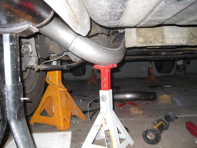

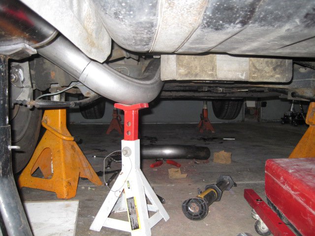

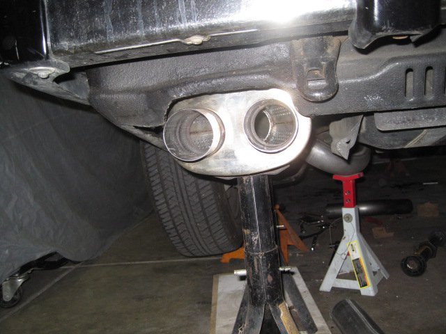

  1. Well I am finally getting around to fabbing up the 3" exhaust for my daughter's 81 280zxt. Anyone that has done this project that wants to share some helpful hints -PLEASE chime in here:) I am planning on a 2&1/2" downpipe transitioning right into 3" the rest the way back. I have purchased 2 bungs so I can reinstall the O2 and later installal a wide band. I do not plan on running a cat. I purchased my mandrel stuff at http://www.mandrel-bends.com/catalog/. They seemed to have the best pricing and a sweet transition piece. I am using all 16 guage aluminized to a dynomax 3" inlet to twin 2.5's. I have started the project-starting from the rear. I think the "over the hump" part around the diff will be the most difficult. Infact, my first ? is the clearance in that area. I tried to take level pics to show how the pipe hangs around the diff area. The bend is maybe one inch below the lowest point-being the sway bar---do you think I have this up tight enough? I am worried about getting to close around the CV. I am planning on using 2 exhaust band clamps(butt type) to make the exhaust removable as needed. One band clamp will be near the front,probably right after the down pipe and the other will be wherever I have another set of factory pipe ends that I know will butt up squarely-probably around the diff somewhere. It looks like I will be able to use all of the original hangar hardware-atleast the rubber hangar parts are still good and I can modifly off of that. Any comments on the band clamps? I know the V style are better, but these are 8$ a piece. I used them on my duals for my 240 and they tightened up nicely, but I have no actual run time on them. I need to find some exhaust tips for the muffler. I was hoping to find some cheapo chrome tips for now instead of the high dollar SS. I know I am sounding like a tight ass here, but I have spent 2k in the last 3 months on this car and my daughter is attending IU right now and you know who is footing the bill. She absolutley loves this car though and I need to get it back to her soon.

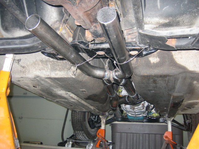

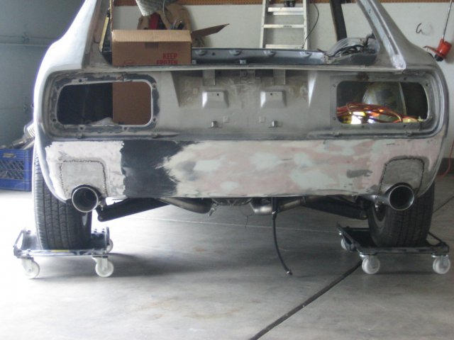

  2. Where the X pipe ended up was just a matter of where it would fit. The L6 set up is NOT condusive to this arrangement. It would have helped it I could have afforded the equal lenght headers from Stahl, but the MSA header,(cheap=affordable) are unequal so I tried to adjust for that after the collector. There is very little room to be Xing around under there. Atleast my car is painted and I can start installing all this hard work. Ironically, I need to finish my daughters 3" exhaust on her 81zxt before I can mess with my car. Way too many Z's in the garage right now:icon6: I like doing exhaust work-except the laying on your back stuff, it is fun fabrication for me. My daughters car will be a challenge too.

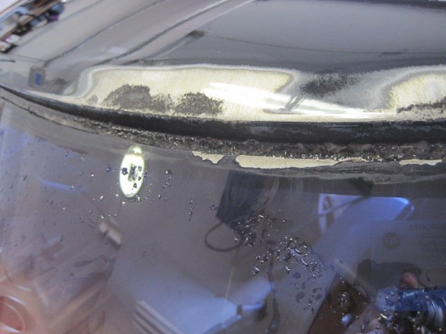

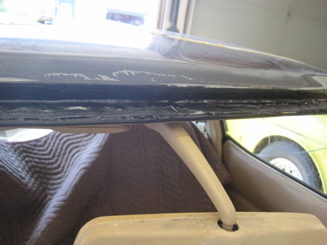

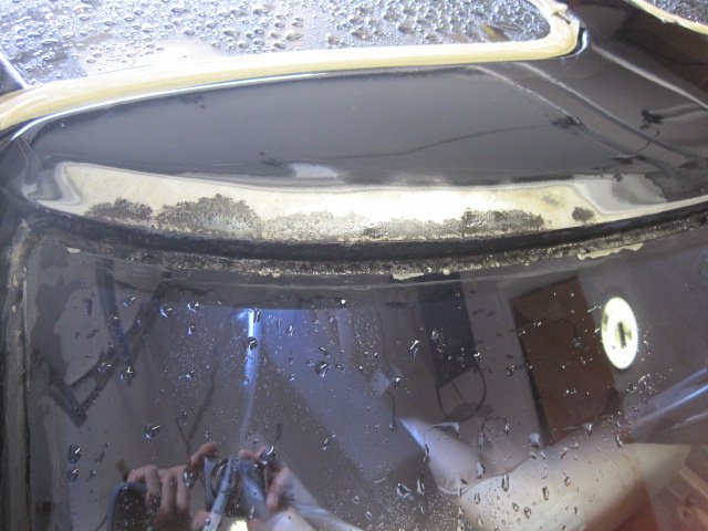

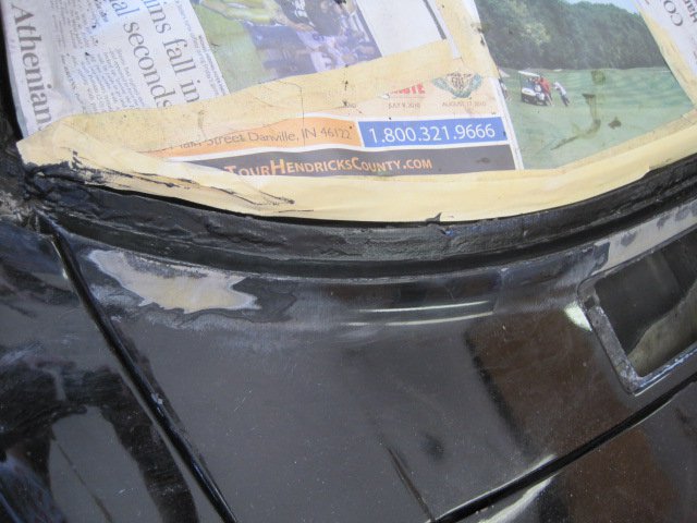

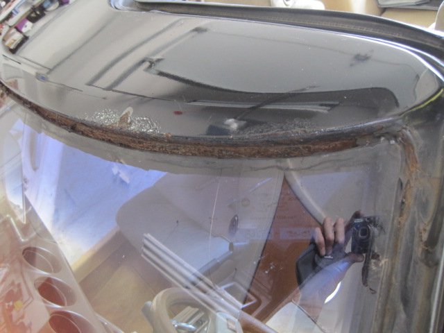

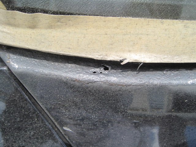

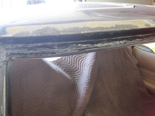

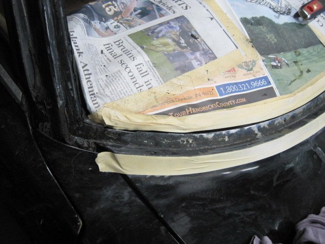

  3. It is kind of funny to call this windshield repair since I broke the windshield taking it out:icon56: I was doing well until the tool I was using hit a snag and I leaned a little too much and next thing I know-crack! I had already researched prices for new ones and found someone to install a new one for 165$, so I could live with the loss. Let me backtrack for a second and say that I did follow my previous plan and sandblasted the area around the windshield before trying to remove it. It actually worked out well to keep the sand out of the inside of the car-even though sand still got in, so maybe that's how the water got in. I really only found one hole where it rusted thru, and that wouldn't have let water inside the car. I think the fact that the rust was so bad that the seal was no longer effective and that seemed to be proven by how easy it was to cut around the glass. The pitting was substantial and must have led to the leaks. I decided on por-15 patch for the repair. It would stop the rust, plus the putty like substance would fill the voids and small holes left by the pitting. I took care to only apply it in the molding area and not on any exterior surfaces that need paint. The exterior stuff I sprayed on por-15 paint to be later top coated with tie coat primer -then finish color. I haven't finished yet, so here are some pics of what I did do.

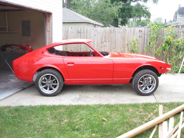

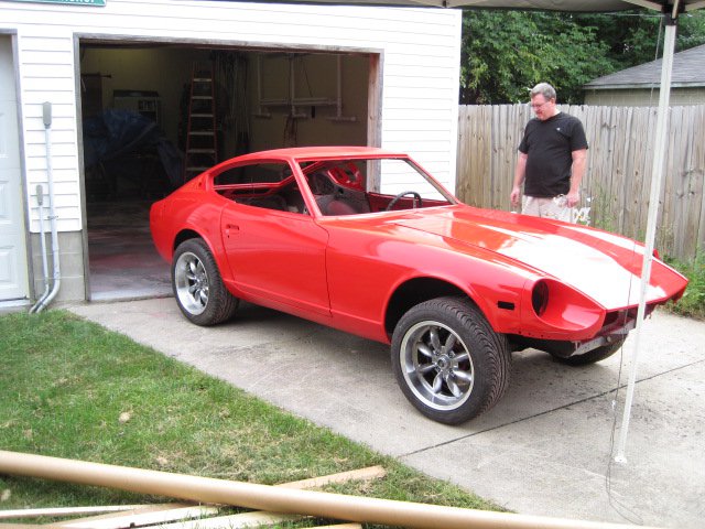

  6. Hey guys, I shared this at CZCC, but I also frequent this site so I thought I would share here also. It has been a long road, but I have finally painted my car. Actually my friend painted the car with my help when i could. The color is true red by Mazda. It is a base/clear coat. It will need some serious color sand and polish, but I am very happy. I can finally start putting my car back together-instead of taking it apart:-D I think the color will work out well since I am blacking out all the trim. This color really blings in the sun.

  12. Your right, a lot of folks don't do the math and think the duals are overkill, but it is smaller then a single 3" pipe. The duals are a lot of work and I hope it is all I want it to be, because it slowed my project down a lot.
  13. I wish I could tell you, but my car is not finished. The car is at the paint booth now, then it will probably be months before I hear my fantasy exhaust. I just thought I might be the first to make a dual exhaust with a crossover pipe for the L6. I have never seen one before and the X pipes seem to do well for scavenging, so what the hell. I wam ending the exhaust with some cheapy glasspacks(12") on either end. This little fantasy has cost me a lot of time and money when you consider that you have to change around your fuel cell arrangement to have symetrical duals out the back. With no basis to go on, I am taking a guess on how this work and sound. 2" pipe also makes for a bit of a challenge because there are more options for 2.5" I had to fab my own X pipe since I couldn't find a 2" prefabbed. I figured dual 2" wouldn't be much bigger then a 3" single, so it's not overkill.
