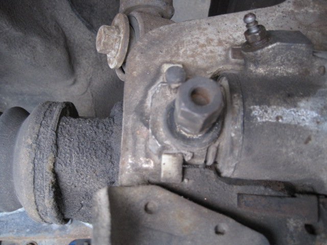

  3. Hey guys I'm in a pickle. These pics are from my daughters 81 280zxt. The rear calipers needed to be replaced. The problem is that the rebuild kits did Not come with the plastic slides or bushings that you see in the pictures. These seem to eliminate up and down play with the caliper in the yoke plate. These did not come the hardware kit or a complete rebuilt caliper and yoke assembly. If you notice my existing caliper does not use or have the horseshoe shaped retaining spring that comes with the hardware kit. Is this spring clip supposed to replace the plastic guides? I have it installed and it does not seem to prevent the caliper play in the yoke. This play causes a clunking sound when the brakes are tapped slightly. Maybe I have the spring installed wrong. The FSM does not show the plastic guides and it does not show the proper installation of the spring clip. I need help-some pictures would help. A simple brake job has turned into a royal PITA!

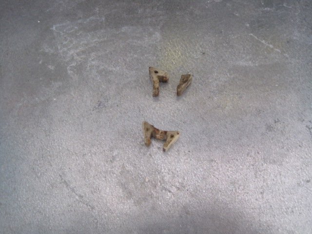

  4. I know a picture says a thousand words -so here you go. These are the plastic spacers I am refering to-that are NOT found in the manual or a new hardware kit. As you see from the pic they are maybe in place of the retainer spring that I got in the kit and are not installed on this caliper. Okay , so maybe I can't paste a picture.
  5. Sorry I don't have a pic for this, but my laptop is in the shop and it's a pain to do on my old desktop. You guys that are familiar with the yoke style brackets on the 79-81 rear calipers should know what I am talking about as far as the plastic guides(spacers, bushings, ect..), what ever you call them, they are the only plastic piece on the cailper brackets. We'll one of them broke on my set up while I was trying to position the caliper back into the bracket. It broke so easy that I'm thinking that they have broken for other folks and are probably missing from other brakes and the folks don't even know it. How important are these and what are they exactly for? It seems to me that the caliper is wedged pretty good in that bracket and can't go anywhere easily. If anything the plastic guides are just that, guides to keep the caliper square in the bracket-correct? Any clue where to get them-probably Nissan only. I actually ordered to calipers from Rock Auto and one came with the complete bracket(5$ extra), which I thought would have the plastic pieces, but NNOOOOOOO, it has everything BUT the plastic guides. Do I even need to worry about it?

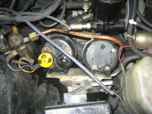

  8. Well I got my reman turbo on and took her for a test spin. I thought with all the things I found wrong with the the last turbo(loose connection at compressor side-WAY LOOSE), the car would feel stronger, but it doesn't. Then I noticed that my guage is not indicating any boost, or much of anything. I have no idea how this is measured-electrically, vaccum, pressure I would think, but how does the guage get its input. I looked all over my schematics and I can't even find it in the wiring. I look at the engine or intake and just scratch my head. Please help out a turbo newby so I can try to figure out what happen to my guage.
