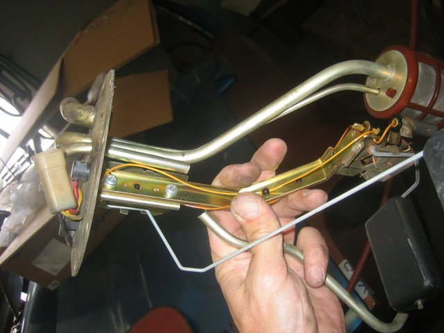

Would you believe that the return line was clogged in the fuel sending unit. After seeing the 100psi on the return side i know I missed something. I have had that same fuel sending unit out probably 3 times and you can see by the pic that it looks brand new. You will also see where I cut the return line to get at the obstruction. I cannot tell you exactly what it was, but I am betting it was somekind of muddgobber from a bug who built a nest in there. I couldn't get at with a piece of wire because it was in the curve of the pipe, so I just cut it off. The passage was completely blocked off, I don't know how the car ran this long

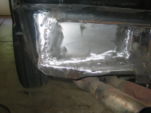

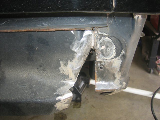

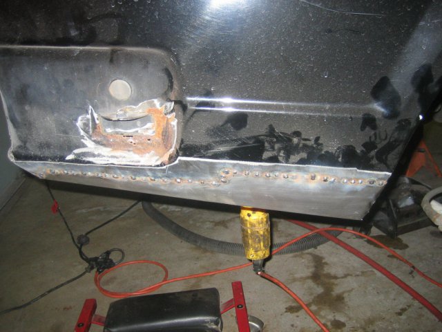

Well I got the car back long enough to do some work on the interior and bodywork. I finally got a chance to see the interior all together with the new panels and carpet and my great find on some original seats. I think when I get some of the more important issues dealt with I will repaint all the plastic in the car. The body work is also coming along. I was able to finish off the drivers lower rear quarter and I started with the back panel and passenger quarter. The passenger rear quarter was much more of a challenge because of the spare tire panel. I spent a lot of time making patterns for the sheetmetal for the inside panels. As you can see the spare tire area really ballooned out when I started looking for good metal to weld too. I only gave myself a day and a half to do all this and really had to rush to get it done. After getting all kinds of sh%t in my eyes(yes I do wear protective eye wear) and mig burn I was able to weld close all the holes before the daughter had to take the car to work again. This is a tough way to do a partial resto-I feel for you daily drivers trying to do this. The next major hurdle is the front windshield. I ordered the clips for the moldings and I have my por15 ready, but still debating whether or not to have someone else do the removal and installation. I think I have the skills and it would cut down on the logistical stradegy of getting someone there when you need them for the install.
