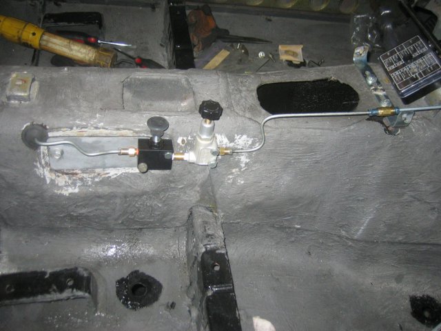

Dave, I will take some pics Sunday, but I put the proportioning valve and the hydraulic brake along the console on the passenger side like Dave shows on his AZC site. It's a PITA to plumb and took me a long time to run it thru the body, that is why I am concerned about getting these flares correct since i have the lines bent already. I probably dumped a cup full of brake fluid on my floor with my first attempt bleeding my brakes since my flares sucked so bad. Of course I didn't notice right away where the fluid was going:oops: -

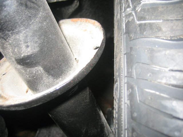

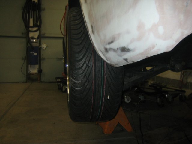

Datfreak, on a 240z you will have to trim the rear quarter lip,or roll the lip, to get 235's. You will have plenty of room on the inside rear, but the front is tighter. I currently have 245/45/17 on mine with stock suspension. I had to trim almost all the lip away at the 10 thru 3 o'clock postion on the rear. The front perch had to be beaten in flat to resume the same clearance I had with the 235's. I will be suprised if it never rubs, but I did run the suspension thru its full travel. http://forums.hybridz.org/showthread.php?t=135971&highlight=hyper+black -

I thought I would update the thread . I finally bought tires and I put on some 245/45/17 general hp ultimaxs. I decided to push for the 245 since there was a bit more selection in this size. Plus I feel I got a great deal on these tires that have been rated pretty high. They have a nice aggressive tread and they are still a 4 season tire. They were rated as having somewhat of a soft sidewall, but that might actually negate some of the harshness of the performance suspension of my Z. As far as the fitment, you'll need to trim quite a bit of the fenderlip off around the 10-3 o'clock position in the rear. I was able to bottom out the suspension with clearance. Whether it will be enough will be seen. There is plenty of room on the spring perch on the rear, just the outside will be close. The fronts took a little more attention to the spring perch. I actually grinded down the radius of the bottom coil on the spring so I could flatten out the spring perch. It doesn't take much at all to gain a 1/4 inch and that's all you have in the end. I actually gained back everything I lost going from 235's to 245's Sorry, no overall pics yet since i just finished up fitting everything and haven't got the car off the jacks yet. Here's a couple shots though!! -
