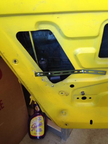

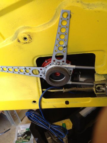

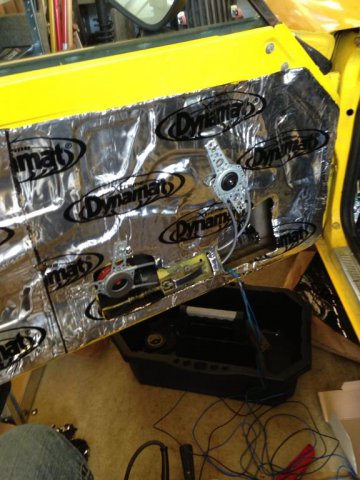

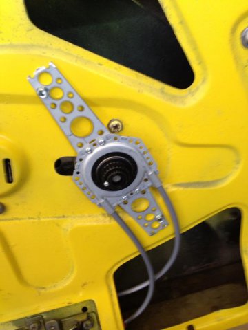

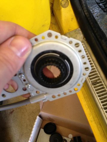

A couple little things I've done so far this spring. Added power locks and windows. Here's how. Step 1. Clean and prep door surface. Step 2. Make bracket and mount door lock actuator. Push pull rod should be parallel to factory rod. Step 3. Mount window motor. Step 4. Make sure to twist the motor leads. Make sure to put on silver clip that holds gears together. Step 5. Mount bracket to window winder. Don't forget the small screw. Step 6. I dynamated the door and cleaned it all up.
