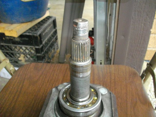

  20. Finally got the rears from TTT. Started to put them in. Everything was going smooth and then when trying to remove one of the stub axles I couldnt get the bolt to turn to save the life of me. Needless to say after a lot of frusteration and time I finally got it off only to see a horiblly stripped stub axle. I took it down the street to a restoration shop and the guy said it was long gone. He can retap it cause the damage is past the thread. Here is a pic of the carnage. So I guess my question is. As long as I have to buy a new stub axle are their any upgrades I should do? Are the stock stubs adequate? I had my eye on the wolfcreekracing cv axle kit. Does that replace the stub axles as well. Any help input or advice would be greatly appreciated. Otherwise Ill just begin the hunt for a replacement stock one.
