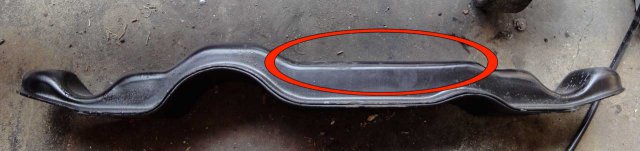

So here's the carnage. I may have gotten a bit over-zealous, but I think I left enough metal to ensure integrity. I misinterpreted my markings on the piece and accidentally cut the wrong area on the passenger side, so that's why so much is missing on that side. -

I think I'll grind the crossmember, I still have a decent amount of work left to do on the car before mocking engine/tranny fitment and I want to be able to put wheels on it to roll around. If it really becomes an issue, I'm sure I can find a used crossmember on the cheap. -

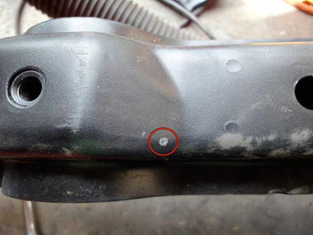

Correct, I circled the first offending area where the bolt hit it in the 4th picture. There was still a good 1/4" left to tighten on the lower mount when it hit. -

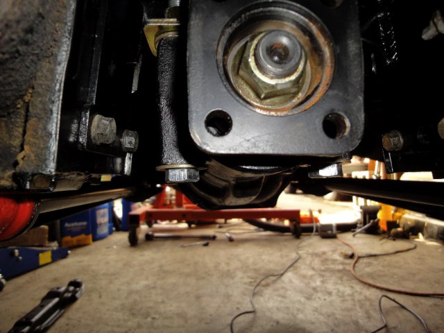

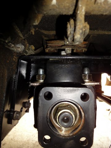

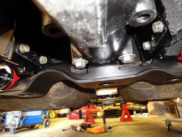

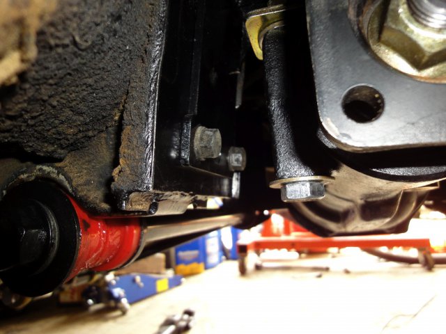

So I finally got around to installing my rear suspension and found that the bolts holding my diff up are interfering with my lower diff crossmember now. I was wondering if it is necessary to notch the lower diff mount as is illustrated here: And, if so, I was wondering how some people manage to sandwich the stock diff mount underneath and not notch the crossmember, as is illustrated here: For illustrative purposes, I have attached pictures of my setup and the trouble areas. Any help would be appreciated.
