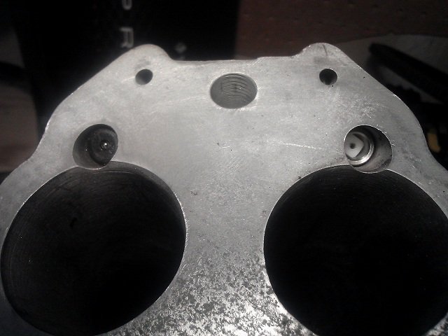

Hey all, I'm in the process of putting my built N/A motor back in my 76. I figured with the expected power increase, I would put in the turbo 265cc injectors (running SDS efi). I bought a set from Autozone, and noticed that they didn't come with the pintle caps. Oddly, there doesn't seem to be a thread regarding upgrading from L28e to L28ET injectors, or what steps would need to be taken. There are a couple of threads relating to running with or without pintle caps, but with differing opinions. Here's a picture of the old vs. new: The injectors fit in the manifold fine, but I'm concerned about the purpose of the pintle cap and me not having them. Can anyone shed some light on what is needed to do this correctly? Thanks!
