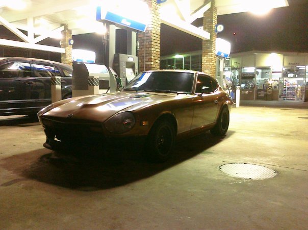

Fixed the spluttering issue: http://forums.hybridz.org/showthread.php?t=155881 Took it for a spin last night just to smoke test it. Some pics: Wheels didn't fall off, but the clutch slave is jamming over extended. Will order a new slave and replace it this weekend. So good to be driving it again. Locked diff is familiar, though the 4.11 gears aren't anywhere near as revvy as I was expecting. Guess thats a good thing. Stock L28E is still slow as sh!t. Dave -
