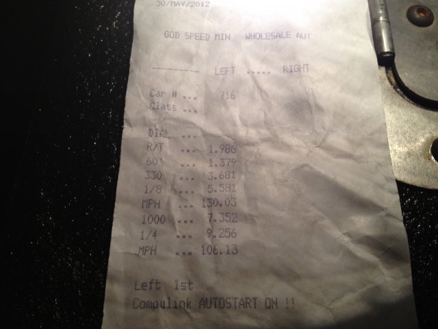

John will be posting the time slip and videos in the next day or so. Thanks Jerry Here is a photo of the time slip of our last 3rd pass. I will be posting video on youtube tonight / Friday. Posted video on youtube. You can search for jnjdragracing, or here is the direct link.
Well we went to track tonight for the first time in two years. The car and motor did GREAT!!!! The first pass was a 5.89 @119 mph in the 1/8th rolled through the 1/4 at 10.00@91mph, second pass turned the boost up and went a 5.74@125mph and rolled through the 1/4 at 9.54@103mph and the third pass we turned up the boost to 18 pounds and went a 5.58 @130 mph,and rolled through the 1/4 at 9.25@106 mph. We had a great night. I would like to thank John(my Brother) and best friend, Chad,JB, And Chris Tuten for all there help. John will be posting the time slip tomorrow. Since this was our first outing with the twins I decided not hang it out through the 1/4 but maybe next time.Jerry

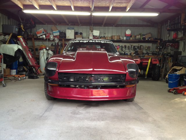

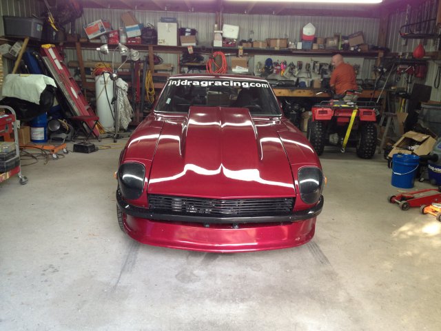

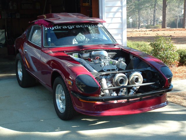

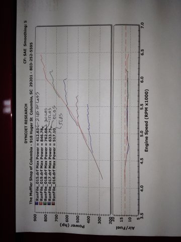

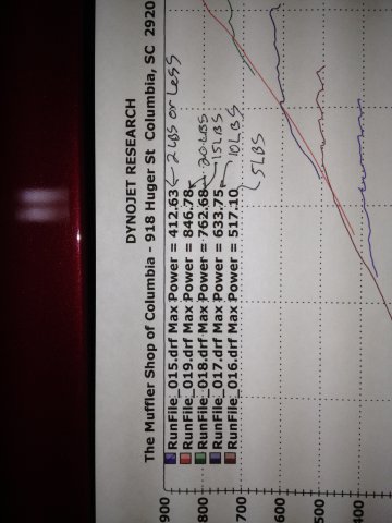

Here are some photo's of the front of car put back together and also the dyno sheets. I will be posting the video footage on youtube this weekend. I wanted Jerry to go up to 30psi boost, but he settled at 20 psi. Off to the track we go. It was so cool, did not have to pull a single wrench. All done with the laptop which was cool. John
We went to the Muffler shop in Columbia today to have the car dynoed, Chris and Brian Tuten have been the Best. Chris started by writing a program for the car, and then we started doing pulls. The first pull with like 2 lbs of boost we made 412 hp, we then went to 5 lbs and made 517 hp, so we then tried 10 lbs and it made 633 hp Yee Ha !!!! We then went to 15 lbs and made 762 hp, but wait we took a vote and decided to turn the wick up a little more to 20 lbs and made wopping 847 hp , and I am on cloud nine. All these numbers are on a chassis dyno at the rear tires.I want to give a shout out to my brother and Best friend John for helping me get to this point. We will be taking it to the track in the next couple of weeks, John will be posting some more pictures and maybe the video of the pulls.

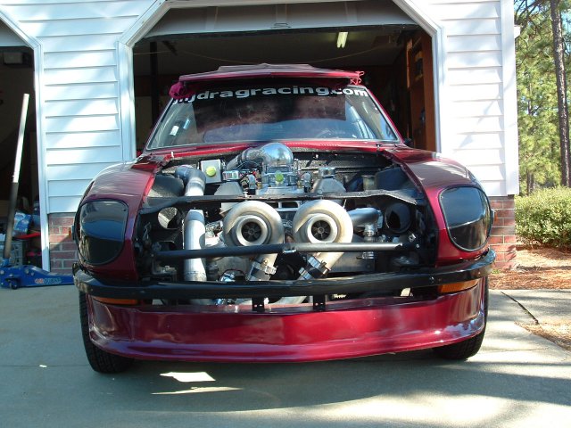

I took the Z over to my Brothers shop ( John ) last week ,so he could get started on rewiring the electronics, and new FAST fuel injection system. Then it will be off to the Dyno, and then the track.

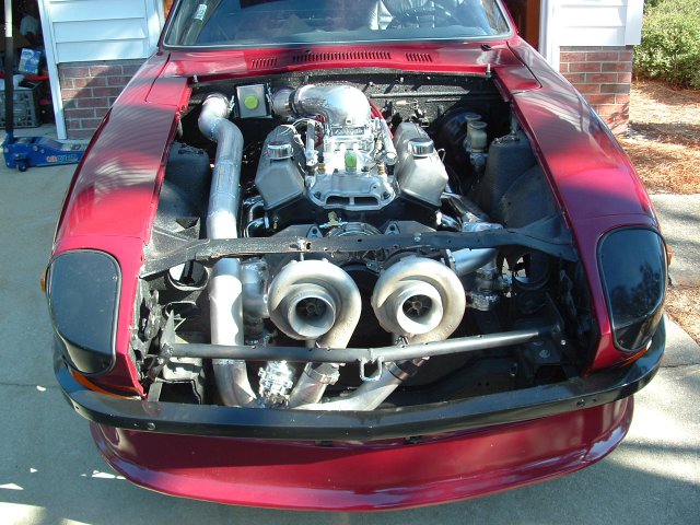

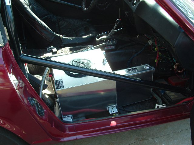

Well were are getting closer, today John ( my best Friend and Brother )came over and finished the braided fuel rail lines and turbo return oil lines while I fabed the mounting brackets for the water tank and trans cooler. We worked on the fuel cell adding the AN 12 bung, and figuring out were to mount the fuel pump in conjuction to the cell. I am hoping to have at the dyno and then the track the first of march.But time will tell.Jerry

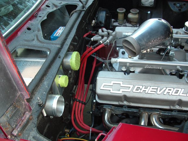

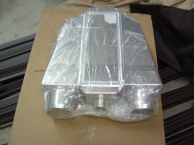

Thanks ,That is a watercooled trans cooler,and water tank that are made by Chiseled performance.

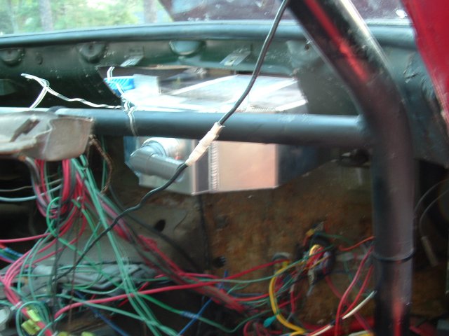

The intercooler is a precision pt 1000 sheet metal , it is mounted in the coweling and comes out just behind the glove box door.
