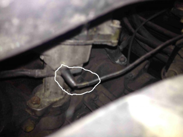

  2. Thanks thats all i needed i had the bottom of it gounded but not the bolt hole. Will work well on my heat sync i built at work. Plan on replacing stock hei with performance one this is just to make sure that was the problem

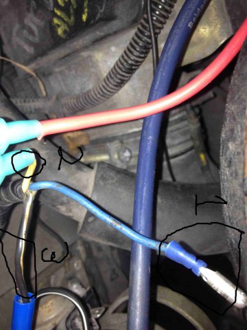

  4. 1: mystery wire that used to go to coil negative (not power or ground) 2: ecu signal wire (according to hei converion diagram over on zcar i think) 3: ECU ground (hei conversion diagram) which doesnt make sense as it has 12v with key on mystery condensor thing. connects to 12v with one wire and grounds to botton of dizzy with other ground wire it all started with my car just not having spark. parked at work ran awesome. 8 hrs later no spark, power to coil injectors fireing so crank angle is working. coil specs out ok so idk what to do

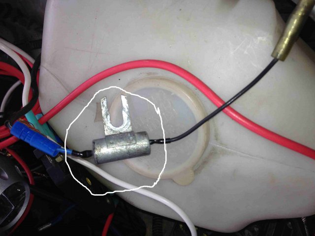

  5. So i have the ingnitor figured maybe. But what is that condensor like thing on the other side of the coil. Nobody seems to know and how can i test it. I think its the culprit
  6. So im coverting my 82 280zxt to hei because it has no spark. Im a bit confused where i need to hook up the power transistor condensor looking thing if someone knows of a diagram that includes that thing eould be awsmome or a picture of where the stock setup went like i should have taken first. I was following a diagram on the swap guide on zcar i think but it seems incomplete like i have extra wires
