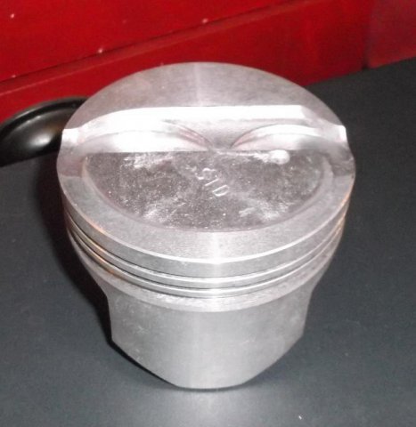

I agree that that is probably a std size Z22S piston with the top machined to both reduce the c.ht. from 35.56 to 33.5, and eliminate the dish. The valve pockets (that don't correspond to anything on the L engine) might amount to 1 cc of volume vs flat top, if that. You can see that there is still a reasonable amount of ring land material above the top ring. This is a very reasonable approach, although you might want to consider a 1 mm oversize (88 mm) piston to work with in order to improve c.r. if you run the P90 head. You might be able to run a Maxima N47 head if you use std dia 87 mm Z22S pistons but you will need to use a big cam because static c.r. will be almost 11:1. However, the closed chamber of that head provides excellent squish which could help limit detonation problems enough for it to work well.
I looked up the compression ht for the Z22 pistons and the Z22S is 35.56 mm, while the Z22E is 32.1 mm. This is not ideal because the target of 33.6 (above) is in between the two. Ideally you'd want a squish table on the piston top to line up with the flat of the cylinder head chamber (P90, P79, or MN47 heads) even if there needs to be a dished section of the piston top to correspond to the open portion of the chamber in order to keep the c.r. in range. OEM Z22 pistons are not going to stand up to severe loads. If you consider custom pistons then you might as well try to consider adapting them to a more optimum rod length for the 83 mm stroke than the 133 L24 rod is. I have purchased NOS L13 rods (from Canadian Nissan dealership IIRC) before which at 139.9 mm make for a nice combination with the 83 mm stroke. They use 21mm pins which is convenient but the rod bolts are only 8mm, not 9mm. Basically these conflicts re rod/stroke/piston specs are rooted in the fact that the L28 block is too short to increase stroke easily and have geometry work out well. In the LD28 the 83 mm stroke is matched to 140 mm rods and makes an OK rod/stroke ratio, which could be higher than that for high rpm applications (i.e., use L20B @ 146 mm or Z20E @ 152 mm) but these would only fit into the taller LD28 block; never the L28 series. If you chose a 140 mm rod to use with the LD28 crank in an L28 block it would mean: 208.1 mm (from above post) - 140 mm - 39.5 mm - 2 mm = 26.6 mm. That is a very low compression ht even for a custom piston, especially if that piston is using a larger pin dia too. It spells compromise however you do it while using the L28 block and LD28 crank. No free lunch. I haven't looked at these calculations in years but IIRC there is a Toyota rod of 138 mm length and 22 mm floating pin with the appropriate b.e. width and journal dia. At 138 it would match to a piston c.ht. of 28.6. There is an Eco-Tec piston, std size 86mm, that is basically flat top that has a low c.ht. IIRC it has a floating pin but only 20mm dia. I have no idea if bushing down a rod s.e. for 22mm pin down to match a 22 mm pin is even doable, much less practical. http://www.summitracing.com/parts/wis-k582m86?seid=srese1&gclid=Cj0KEQiA4eqyBRDUh7Omv9vCtsoBEiQAspfs8mhmuZ0xqytty85FvYETUbrul4E0xqrhcP-h4ln8-fEaAssx8P8HAQ The c.ht. is 26.75 mm which is a bit too short for a 138 mm rod (would need 28.6 to be zero deck) but it is very close to the 26.5 mm needed for use with the L13 rod (139.9 mm). The rub is that the L13 rod bolts are only 8mm, otherwise the s.e. for pressed fit 21 mm pin could probably be bushed for the 20mm EcoTec piston pin. L13 parts won't be found in US market but maybe JDM, AU, NZ, etc sources. It's a quagmire but in general it seems that compression hts of pistons in newer engines are lower than in older engine designs so it is worth browsing specs every now and then. see: http://www.wiseco.com/Catalogs/SportCompact/CompleteCatalog.pdf

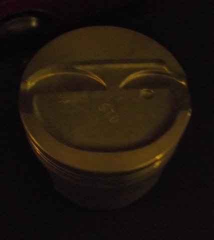

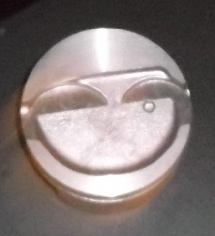

Those JE pistons do look similar. See how three are the reverse configuration re exhaust/intake reliefs? The problem with using pistons from a V6 in an inline six engine is that three are going to be the wrong piston pin offset for the rotation direction. That's why I was going to cut the exhaust valve reliefs to be symmetrical to the intake valve reliefs on all six pistons. It is a compromise but not giving up much for the sake of attaining good squish and keeping c.r. useable on high displacement engines. I hadn't considered valve-piston clearance as even an issue in what I'm referring to because it looks like there is plenty there. (In that sense I hijacked the thread) Again, this is more of an issue on L4 engines because there are no raised roof/closed chamber heads available for L4 as there are for L6. Anecdote: I bought a rather hacked up road race 510 years ago, 1600 cc, and I had the head off for some reason and noticed that there were nicks in the piston tops on #2 and #3 cylinders from intake valve contact (not enough to bend the valves). That was because PO had the #2 and #3 pistons assembled into the wrong holes. They were nice forged pop-up pistons. I reversed them in their holes, sorted some other things out, and raced SCCA Solo I and II with the car. PO was a dyslexic engine builder I guess.
they aren't custom pistons, they just happen to line-up flat-to-flat tables. Pins are 21mm; c.ht is 34 mm. After fly-cutting, the intake eyebrow would match symmetrically to what you machine in next to it...the identical eyebrow. It is an experiment but seems sound.
Here is what I am referring to: ...the table on the piston top is juxtaposed to the table on the cyl head = squish/quench, etc = high c.r. resistant to knock.

I guess I'm not sure by what you mean as chamber matching. I think that is what I'm refering to re matching a flat portion of the piston top up with a flat portion of the cylinder head chamber to maximize squish. The dish portion of the piston top is needed to keep compression ratio down. This would apply in L6's to larger displacement than unstroked L28 where you want to use a closed chamber head but can't use full flat top (no partial dish), or the c.r. would be too high.
I had considered a project that I have not followed through on that is related to your post. I was looking at different piston head configurations that might maximize quench with a closed chamber head, and at the same time allow for enough total chamber (head + dish vol) volume to make reasonable, useful compression ratios in L4/L6 engines, and that have usable pin ht and pin dia. I selected pistons from a Toyota 3L V6 3VZ-E (87.5 mm bore) and would use 3 + 3 for the side that gave the correct side thrust/pin offset. (must buy 2 sets of 6; discard 6 for the other side of two V6's). I'd have to look up if I kept L or R; but it's easy enough to figure out from the L6 offset. The problem is that the valve reliefs are different sizes (to correspond to intake and exhaust valves) and half of the inline 6 cylinders will be mismatched re which valve is where on piston vs cyl head location. If you study the pistons you will see the conflict. So, I was planning on fly-cutting the piston tops for intake valve-sized reliefs to be symmetrical on all 6 pistons (because I couldn't go smaller on intake reliefs that were corresponding to exhaust valves in head; but I could make all piston tops match). I still have the pistons (new from Ebay) but haven't had the time to play with the project. It actually has more potential for L4 because there are no closed chamber/large vol chamber (like P79 and P90) heads to choose from. This limits even using flat top pistons if you want a larger displacement L4 and a round-bowl type dish would give up quench, so the configuration of the 3VZ-E piston top might be useful. This type of idea is for those on a strict budget. I would just order expensive custom pistons if that were within my budget. DAW
