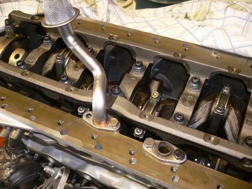

  19. With this mod you show, will a RB20/Z31 pan just sit right down on that block with out any mods, or are the usual mods still needed to the rim of the pan, to bulge it out around the added pick up mounting flange? Please explain the baffling mods needed, if any, to the pan also, if you can... ------------------------------------------------ Thanks JS, the pan does need modifying as you suggest. I will put photos of that on my site soon (I am in Europe on holidays at present for 6 weeks). The pan needs cutting and stretching out over the point of the base attachment & rightangle bend. The baffle inside needs cutting to allow the horizontal tube to run along to the RB20 standard attachment. We used a simple copper 90degree bend to get the pipe to go from the standard RB26 pickup point back to the RB20 pickup pipe work which kept it as low as possible and neat.
  20. Here is another example of how the pickup can be modified when using the RB20 sump and RB26 motor in the Z. I will put up the whole fabrication on my website soon.
  21. thanks all for your comments, makes me feel a lot better about it. Cheers
