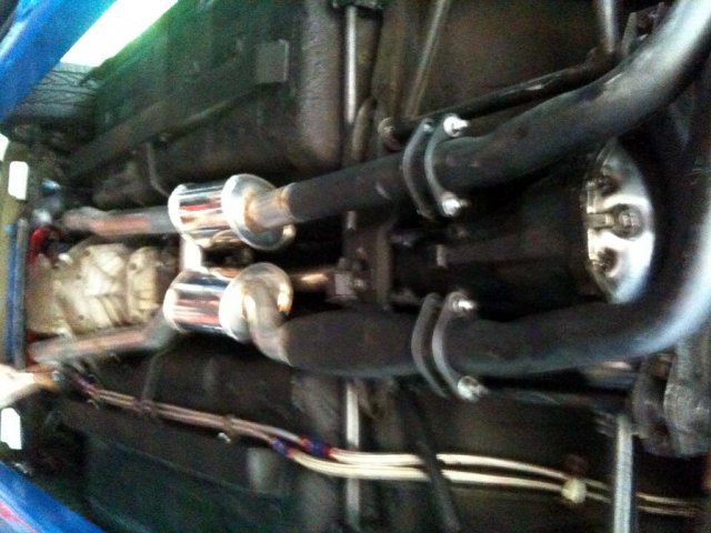

Well - I'm having some difficulty with the driveline angles and could use some help. I had the RT Mount installed today. It lowered the nose of the diff so low that the installer had to notch the crossmember so the 2 bolts woudl clear, and I now have a noise on deceleration which I would characterize as interference - it matches RPM and is continuos until I give it gas. Also, I have been frustrated by a vibration in my driveline - (I have an LS1/T56 JCI conversion) - prior to the install of the RT Mount, the vibration started at 80 mph, now it starts at 55 mph. I hope to be able to get it on a lift tomorrow and check out the angles better... Can anyone share any experiences? I have always felt the the JCI 280z Tranny mount (not the 240z mount) causes the rear of the tranny to be about an inch too high... just eyeballing it
So I could use some expertise... I had the RT Mount installed today - local shop did it for me... This eliminates the stock lower mount and replaces it with a polyurethane upper mount which is mounted at the top. The shop had to notch the lower cross member so the bolts would not interfere. They also had to modify my sway bar mounts to lower it slightly because it was too close... Effectively this lowered the front of my diff around 3/4" The vibration now starts at 55 mph. I guess I now know for sure it's the driveshaft - the question is now what to do about it. In the attached picture you can kinda see how the cross member is notched - or if anything else looks suspect feel free to make suggestions... Sorry for the lousy pic from my phone...

Wheels were recently balanced so I've eliminated that... I've done the z31 CV conversion, so the rear u joints are eliminated (although I will check it out again). The drive shaft came from JCI brand new and balanced.... I have always suspected that the tranny mount caused the driveshaft angles not to be optimal - just eyeballing it, it never looked right... And with others having stuff coming loose in the driveline in other posts I am going to start there... I'll share my findings... Has anyone experienced vibration from the z31 CV conversion??
Hey all Today I'll be spending time on my back under my Z. I had posted my suspicions on other posts where members have raised concerns about driveshaft bolts coming loose(mine are still tight). I have always suspected that this is due to drive shaft angles... I have now driven my Z 1,300 miles - it's ok if I stay under 65 but as you approach 70 it starts to have a sound vibration resonance, then by 80 mph it vibrates pretty bad... I think the solution will be a combination of the RT mount (which I already have) and lowering the rear tranny mount to reduce the upward angle slightly (I have the 280z mount) I would like to know if others have experienced this issue. I have also slotted the holes in my tranny mount so I have adjustment from side to side.... What are the optimal angles and what is the best way to achieve them? I guess I'm going to have to invest in a good laser angle finder. I have researched and found that the angles have to be equal front to rear and they cannot exceed 3 degrees...
