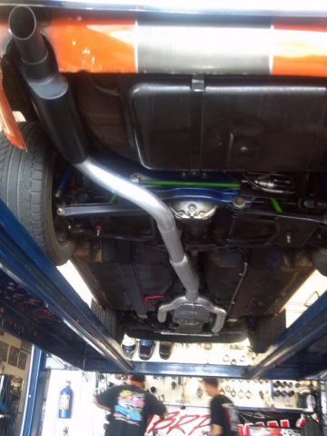

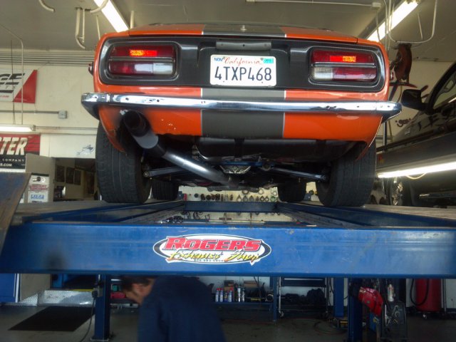

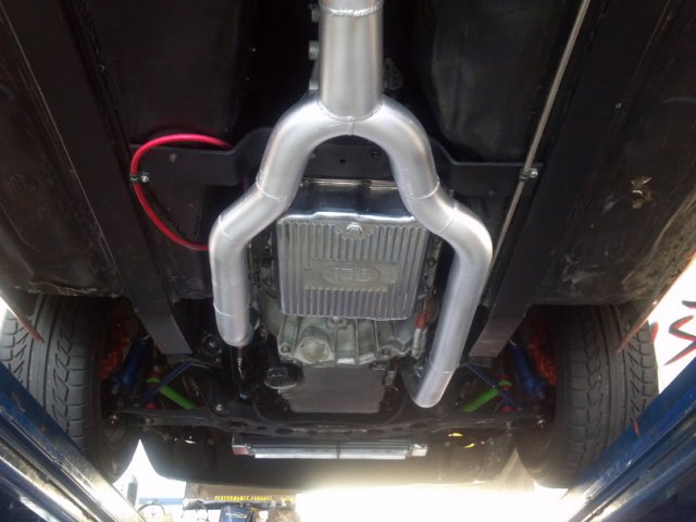

JTR 1-7/8" headers to 2.5-in. mandrel bent exhaust, merging into a custom built 3-in. y-pipe, then 3-in. mandrel bent all the way to a 3-in. spiral core resonator and then a Flowmaster 40-series muffler. My exhaust shop supplied all of the materials. I asked them about flex connectors and there were against them, however, if I were to have issues with exhaust leaks at the collectors due to not having them they would install them for free. The flanges provided by JTR are abolute ****. Mine were thin, warped and out of round. The shop supplied some nice thick (very similar to the JTR flanges) flanges. -
My new exhaust - pics and video inside
ktm replied to ktm's topic in Gen III & IV Chevy V8Z Tech Board
Correct, 2.5-in. into a single 3-in. The exhaust cost $590 and includes two thick laser cut flanges for the collectors, 4 O2 sensor bungs, all mandrel bent pipe, 3-in. spiral core resonator, all hangers, and the muffler. Well worth it in my opinion. -

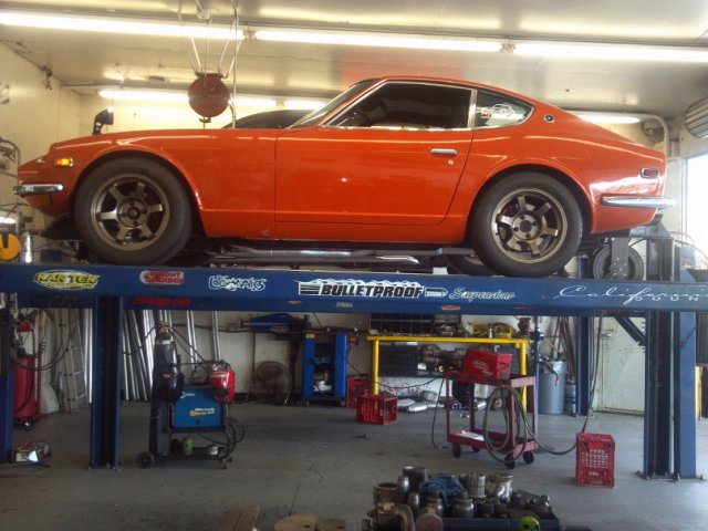

The wheels are Rota Grid Offroad, 16x8 +10 Here is the original exhaust. It is a bit more hollow compared to the new exhaust which seems to have a fair bit more lower frequencies. -
When I completed my build back in July 2011, my neighbor across the street recommended an exhaust shop relatively close by. My neighbor has had numerous street rods, primarily original '30s, and this shop was (supposedly) frequented by hot rodders. However, over the course of the past year, I noticed numerous issues with their work ranging from incomplete welds around pipes that allowed air intrusion before the O2 sensors, hangers breaking and leaving holes in the pipe, rigid hangers that transmitted all vibrations to the cabin, numerous transistions with crushed bent pieces, clearance issues with low hanging exhaust, and to top it all off, a Flowmaster CLONE was installed instead of a true Flowmaster. Many of my performance and tuning issues were due to this rather crappy exhaust system. I just had a new system installed by Roger's Exhaust in Fontana, California. I originally wanted Roger's to do my first install, but the towing charge would have been around $200. My neighbor offered to tow my car in his enclosed trailer to the shop close by and at the time the shop close by made sense. Lesson learned. Roger's Exhaust is talked about highly on LS1tech.com and they seem to have a lot of postive reviews. I spent the entire day at their shop. They were forthright with their pricing and Roger's brother Sparky did the entire fabrication. His welds are fantastic and he has a lot of pride in his work. They managed to tuck the exhaust up another 0.75 to 1-in. using all mandrel bent pieces, added a nice spiral flow resonator (which was DEFINITELY needed - the drone at 1700 rpm rattled my brain), built a custom Y-pipe, and topped it off with a Flowmaster muffler. Below are the pictures and link to a sound clip. For those of you in So. Cal. looking for a shop that does nice exhaust work, check out Roger's Exhaust in Fontana.

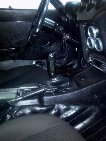

I don't know if this helps, but I installed a B&M Stealth Pro ratchet shifter on my LS1/4L60E setup. I have a 1972 240z and needed to trim the shifter opening slightly in the front and back. I created a cradle that bolted to the underside of the transmission tunnel below the shifter hole. The cradle holds the Stealth Pro so that the shifter arm is in the stock position and does not stand up very high.

I don't worry about it. I have a 4L60E with a B&M Stealth Pro ratchet shifter. Dust boot? What is that? -
