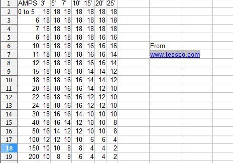

Find out what amperage the fans pull when turning on. This will always be higher than the operating amperage. Size your fuse for the amperage draw when they turn on otherwise you'll be popping fuses like mad. My Flex-a-lite 210s pull 20 amps when operating and near 30 amps when turning on, so I use a 30 amp fuse. I found this chart a long time ago when I was wiring up my car. I thought it was a PDF/image, but it was a Excel file. Quite honestly, you can't go wrong with 10 ga wire. Your Ebay fans probably draw no more than 20 amps when operating or 30 amps on startup and the length of wire will be less than 10 ft. Your relay will most likely not be sized for 10 ga, but you can make it fit though it will be tight. -

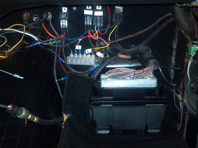

Below is from a PM I sent another member: Attached is a photo showing my power center for my swap. I have not gone back and cleaned up the wires since I completed the swap. I want(ed) to make sure everything was running smoothly before hiding wires. At the top of the photo you will see four 30 amp relays. Each relay controls different systems. The first relay on the left supplies power to the 8 circuit fuse block you can see in the middle of the picture. The relay is control by an ignition hot wire which makes the fuse block an ignition hot block. The relay supplies ignition hot power that the PCM uses and I must find another constant hot source for the PCM elsewhere. The second relay from the left controls my electric fans. I have only 1 speed fans (Flex-a-lite 210) thus need only one relay. I use the low speed wire from the PCM to control this relay. The 3rd relay controls the fuel pump. This relay is different than the others in that the PCM SUPPLIES +12v instead of pulling to ground. The last relay on the right is for the torque converter lockup (I am running a 4L60E). The fuse block is a simply 8 circuit block I picked up from an industrial electrical supply store for $15. The injectors, coils, PCM and sensors get ignition hot power from this block. At the extreme right of the photo you will see two green maxi fuses. These fuses are for the fuel pump and electric fan. The battery feeds the fuse block directly and then power is distributed from the fuse block to the respective relay.
