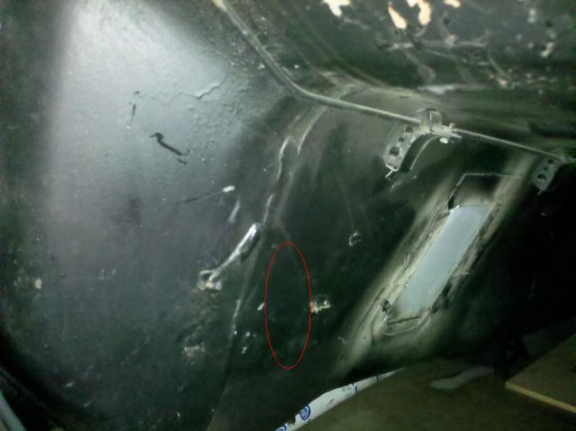

Dudeboy, it sounds like the same area as shown by Dan's picture and my circled area. You can see the seam between the firewall and passenger area. I was wondering about that big honkin ECM plug. I have a few BFHs; as a matter of fact I had to use one on the JCI mount that "slips" into the driver's side tower. Yah, right. At least there is no slop there. I plan on using either a hydraulic jack or a scissor jack to push out some room....at least that is the plan until it doesn't work and then out come the hammers.
I installed JCI's engine mounts over the weekend and started preparing the transmission tunnel as well. JCI's engine mount for the passenger side has a bolt hole that lines up with the hole in the crossmember tower. I did not see in JCI's manual where this called to be bolted together like the driver's side. I re-read the manual a few times and searched Hybridz but to no avail. It seems to me that this should be bolted up or else the mount itself will flex. I started work on the transmission tunnel as well and took a few measurements to locate the area on the tunnel requiring clearance for the 4L60E. I know that it is the servo housing on the transmission the requires the tunnel to be clearanced. The area I've identified is shown in the picture below outlined by the red ellipse. Does this look correct? How far up from the bottom of the tunnel must be clearanced? I do not know the relative position of the trans bottom to the tunnel bottom. The archives talk about clearancing the tunnel but mainly focus on the T56; those threads that discuss the 4L60E make no mention of the area nor provide a picture showing. Thanks!

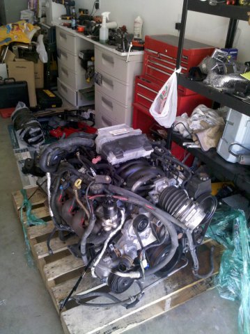

Happy days are here! The engine was delivered with no apparent damage either. I got the JCI mounting kit in the mail yesterday and JTR's ceramic coated headers on Friday. I've been loving Summit loooong time lately as well. The Corvette fuel filter arrived along with the Russell push-on EFI AN adapters for the filter and rail, HP Tuners will arrive by Friday as will my B&M Stealth Proratchet shifter (yes I know you cannot manually shift the 4L60E), Transgo HD2 kit, B&M trans cooler, TCI finned trans pan with plug, and B&M remote trans filter. My stainless steel tubing will arrive Friday as well. I am replumbing my old SS braided lines to SS tubing. I plan on having the engine in the car by the end of June and running by the end of July. -

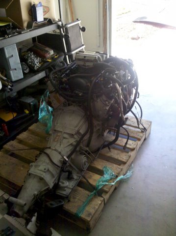

I've been thinking about doing this swap for 2 to 3 years now but never really moved on it. After my little incident installing my worked head on my L28ET, I snapped. I could not believe how much money I had in that setup, enough to fully fund my LS1 swap. I just picked up a complete 1998 LS1 and 4L60E from a Camaro SS with 80k miles for $2500 + shipping. It comes with all sensors, PCM, maf, harness, etc., a complete drop out. JTR headers and JCI mounts & driveshaft will be ordered on Monday. I've been researching this swap for a while now and am rather excited. I hope to have it running by the end of July. Man, I should have done this 2 years ago.....

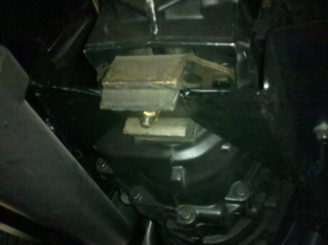

Maybe I was unlucky, but my 5-speed was spitting metal chunks (not just shavings) with 330 lb-ft at the wheels. I've since upgraded to the Z32 tranny. The Z32 actually fits better in a 240z than a 280z. You need to extensively modify the transmission mounting points on a 280z, while for a 240z you simply build a different transmission mount that bolts to the stock location. Attached is a rather grainy picture of my mount, but you get the idea.
