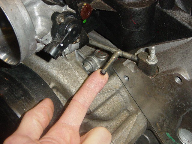

LS1 guys - ?? about coolant line under TB
1 tuff z replied to VinhZXT's topic in Gen III & IV Chevy V8Z Tech Board
vinh, here's a pic showing how i ran it. the silver upper rad tube has a bung welded in with a nipple threaded in where the other end of the steam tube attaches. i rotated it underneath so it's basically hidden and, as you are working toward, keeping the engine bay as tidy as possible. [http://album.hybridz.org/showphoto.php?photo=5241&size=big&cat=500&page=2] -
