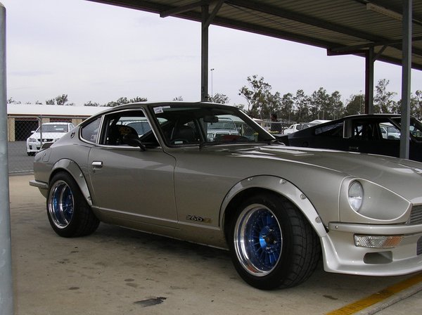

  2. Yeh thats my two seater in the background, better pic of it here http://forums.hybridz.org/showthread.php?t=138065
  3. Make of the front spoiler? Its a modded AU domestic one, not bad but not wide enough for those wheels.

  5. SSR Longchamps above, the best. Meanwhile below we have a set of Jongbloed super light racing wheels a mate imported from the US. Don't know the sizes, tyres are Toyo R1 semi slicks.

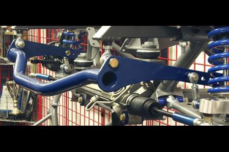

  10. The blue anti roll bar pictured below has its arms welded to a hollow bar which should be spring steel. There are stick welding rods available which it is claimed are suitable for such welding, 303 I think is one. But rather than rely completely on just weld to hold such arms, I'm thinking of deforming each end of a hollow bar cold and having arms which have a matching hole which can be forced over the deformed part and then welded. Or is that overkill, keeping in mind that I don't have any heat treatment etc knowledge.
  11. Jon's design is a good one but I like the idea of fabricated arms which can be drilled for some adjustability. So I'm going to shift a question on welding the arms to the bar as done in the blue one pictured above over to Welding/Fabrication. .

  13. Is your setup similar to what Tube80z mentioned in this thread Jon? http://forums.hybridz.org/showthread.php?t=105596 Here is a pic of another solution, only thing is I'm not sure about welding the spring steel hollow bar.
