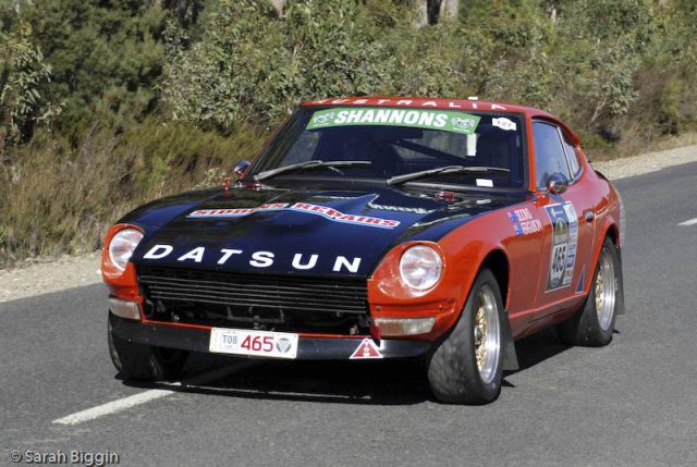

  1. The influence of the front bumper on airflow is an interesting one, there seems to be a trend (in AU anyway) to run competition S30's without one. Thats in classes where very few non standard tweaks are allowed. Eg here is the S30 which won its class in this years Targa Tasmania.
