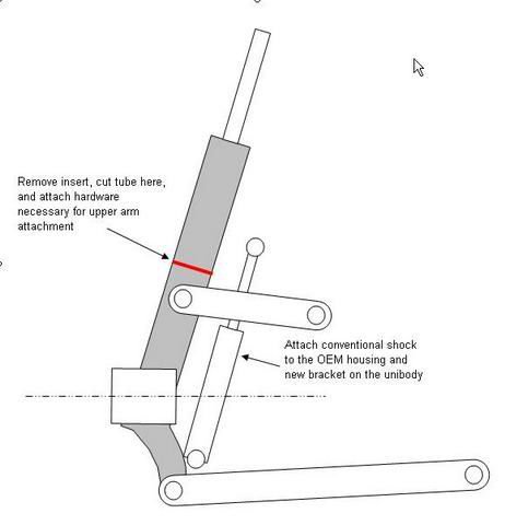

Not trying to discourage anyone from doing a double A arm conversion, provided they aware of the challenges involved. Really to do it properly the car would need to be put on an alignment frame so the new mounting points can be located accurately so its not really your average DIY project. There have been previous discussions on this same topic with pics and measurements of various possible donor parts. It would also be possible to make up a front end from parts available from those stockcar race places. Anyway, here is a sketch of a double A arm conversion of a stock rear strut I took from this forum years ago. Sorry don't know who the original poster was, perhaps something similar could be done for the front. From memory someone actually did this conversion.
