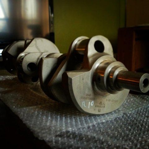

Saved 500$ going with an eagle crank, its .10 undersize on the rods.. factory regrind. Machine shop checked it out and saw no flaws, I'm happy. I might switch my rods over to scat I beams because the h beams are bigger in an already really tight fit.. we'll see in the next few weeks what happens.

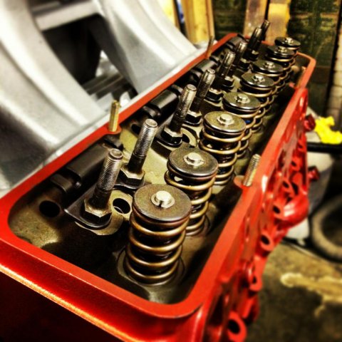

Valve train photo, part numbers if anyone is interested. 73925-16 Springs 75794-16 Retainers 77048-16 Locks 78518-16 Seals 86731-16 Locators #73925 Dual Valve Spring 1.306" O.D. 0.676" I.D. 153 lbs. @ 1.810" Seat Load 400 lbs. @ 1.150" Open Load 0.660" Maximum Valve Lift Pushrod guides are 5/16 raised made by allstar performance. They are 18$ on summit.

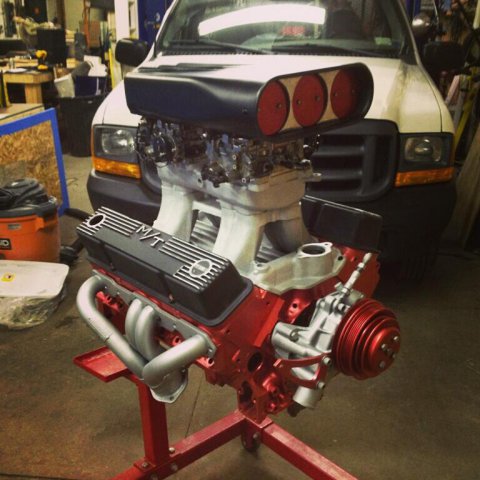

Ill try and keep this updated as parts arrive. Currently waiting on the rotating assembly, scat 1-40900-Bi 4340 3.875 stroke 6" H-beam rods and forged pistons 11.4:1 compression Heads are world products sportsman II built to hell with a complete lunati valvetrain max lift is .660 Hedman headers Msd 8691? I think pro billet dizzy Edelbrock tunnelram with dual 1403 carbs and enderle scoop (Carbs will probably be swapped for holley 450s) Cam is .241/.249 @.50 and .525 /.541 lift 110lsa 106lcl Block is arp studded through out Block Is a 4bolt main 010 high nickle content Pic is of mockup, tracing out gaskets and removing paint for good sealing

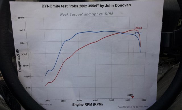

Actually, now that I think of it.. I used to have an isky 280 mega cam. That was in my 355. I loved that thing, I had iron heads at the time 10:1 Here is the dyno, 700r4 transmission and a 2600 stall. -
