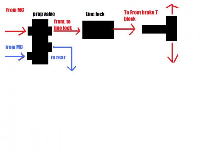

That's the part im getting hung up on, the one on the firewall is a full blown proportioning valve, the one on the cars engine bay fender is also a type of proportioning valve, it also has the warning light switch in it.. if fluid goes to the fronts or rears more than the other the piston inside moves and trips it. However, it has 1 in, 2 front outs and 1 rear out.. I don't know if i can just remove it entirely. It's already unplugged and has been like that for 2 years now. -

Can the brake pressure differential warning light be bypassed? My line lock only allows for one line in, and one line out. I've searched and cant find an answer.. I drew a picture of how the brakes will be set up. if anyone has a suggestion on how to run the lines with the original warning light switch please post an ms paint drawing, this things boggling my mind on what would be "safest"
