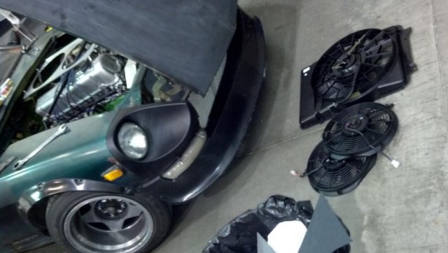

I think those are ZX guys (not anything wrong with that...) But the Taurus fan from tip of fan hub, to back of motor cover sits about 1" into the water pump. I even removed radiator and water pump to see if I could mount it and cut holes in the shroud to make pump fit recessed into the shroud. Nah, it no fit. But man it blows some air! Just listed my NEW unused fan, Volvo relay and BMW switch on Phoenix Craigslist.
I do a little flying for fun and a little for work (which is still fun). I bought and installed an Arizona Zcar radiator today and abandoned any hope of running the mighty Taurus fan. But is sure is fun to hook up to the battery...
I bought a really cool distribution block from a car stereo place. It has a cover and all which is required for some racing applications. Now I have BIG wire from my Alternator to battery and a BIG power supply ready for my next fan du-jour... Please visit my "Museum of Fan Failure" I shall now retreat gracefully with my visa bill in hand and revisit the search function. I just KNOW I am going to get called to the Moderators office for this screwup.
On account of the Taurus fan no-way fitting in front on an L6 I turned on the drinkin light early... Contact me for the forthcoming sale of collected parts You may begin scathing personal attacks now. Reminder to self: search first
