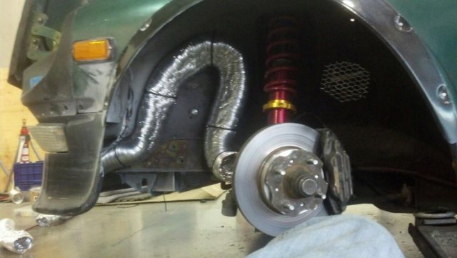

Lets see those brake ducts!
duragg replied to Kevlars30z's topic in Brakes, Wheels, Suspension and Chassis
Ducting is a HUGE difference. Tracked at INDE all day today and the difference in temp (my hand on wheel) is gigantic Rears are warmer for sure. I pulled a little rear bias out. LOVE cockpit adjuster. -
Nothing to rear? Lokks harder to plumb. Rear rotor hubs have a neat blue rainbow... -
I bought dinky 3" alum flange things from Aircraft Spruce and 3" Toaster Oven duct from Lowes. It doest rub at full lock static. Who knows what will happen after I launch off a burm sideways this weekend. I squirted directly at the vented rotor center. -
