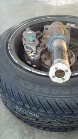

Fronts from top down: Nut 5 washers to takeup the extra space of the BZ3099 Toyota struts Insulator with hole enlarged to the size of the Bz3099 threaded area. Bearing, repacked and pushed into insulator with a little RTV to keep it in place. Tophat Spring Bumpstup -

Did a mockup of the rear struts and new Disks. Pressed, greased and torqued the new 27spline 280z style beefier stubs. Mounted brake adapter and the 280ZX caliper which was an easy fit, and lots of room in the new wheels too. It was a snap to get the giant breaker bar on the axle nut for the 180-230 ft lbs. I may have reefed on it a bit too much... -

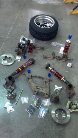

Almost ready for the full swap: I need a little help on a couple questions: 1) Any reason NOT to load the rotors, calipers, bearings, Control arms and install as one unit? Versus installing the LCA, then Strut, then caliper, brake etc? 2) On a normal coilover install with 10" springs, cut per the STICKY will the springs always normally be compressed by the collar? If I accidentally become airborn, will the springs float loose for a moment, I worry about the bearing in the front falling out of its slot if they do. 3) Boots to protect the shock shaft? Or pointless? A few final items to acquire and the swap will be ready. -

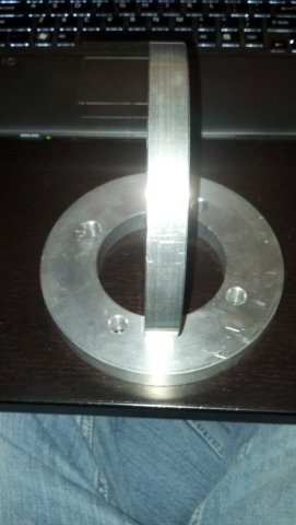

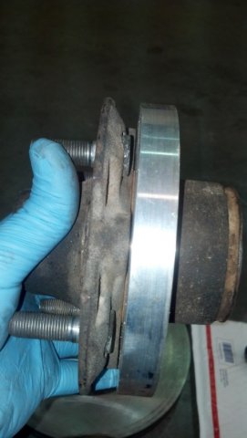

Spacers in and fit good. I needed to make a slight bevel to the ID where it meets the hub to mate to the hub filet. Getting all the parts to fit snug and flat is important. There isn't a great way to center the rotors on the hubs via the bolts, so it took some trial and error to make them run true. Super product. Thanks to Silvermine for shipping so fast. Tj -

Silvermine spacers arrived. Nicely machined. They measure .671". I will mock them up tomorrow and see if that does the trick. Tj -

Oh, and a big thanks to "RB26powered74zcar" for offering his parts. And to Silvermine Motors for answering my technical emails, offering the extra bolts I needed and shipping same day. Tj -

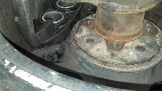

The very outboard lip of the Calipers just kisses the hub flange a touch. Used my die grinder to shave down the caliper just a bit and got clearance. Figured there would be plenty of meat there between the caliper well and the edge of the casting Boatanchors... -

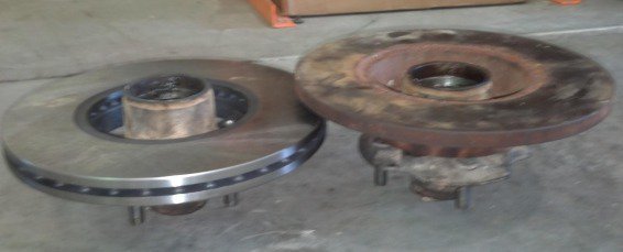

I have scalloped 240 hubs. I need the thicker ones. Looks like just under 3/4". Silvermine will ship for me. -

That picture is so small, I can't tell... ha. No, but yeah I am. I can machine some spacers which will take me all day on a lathe. Or, buy the Silvermine spacer. Or troll here for a mercy spacer... -

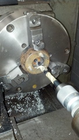

Focusing on front struts now. Machined top hats for the .587" BZ3099 Mr2 insert. Need internal bump stops. Probably will install shock baffles to protect the shaft. Need spacers for me S12W / Z31 new brakes Need ball joints. Need LCA bushings, already pushed out old ones. Need TC rod bushing kit. Then fronts will be done and ready for fender cutting and ZG. * Please forgive me for uploading inappropriate image sizes. I thought I had resized my images, but failed. -
