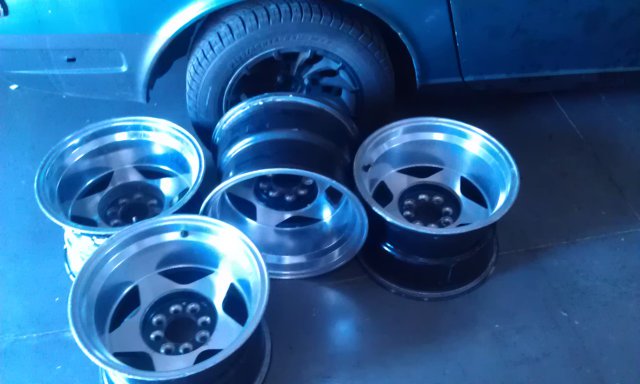

15 x 10s! Can't wait to finish coil-overs and cut the fenders to make room. Actually I'd like to find somebody with a 15x8 in the identical rim to swap 2 for 2 so we can all stagger... -

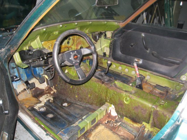

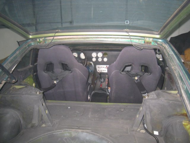

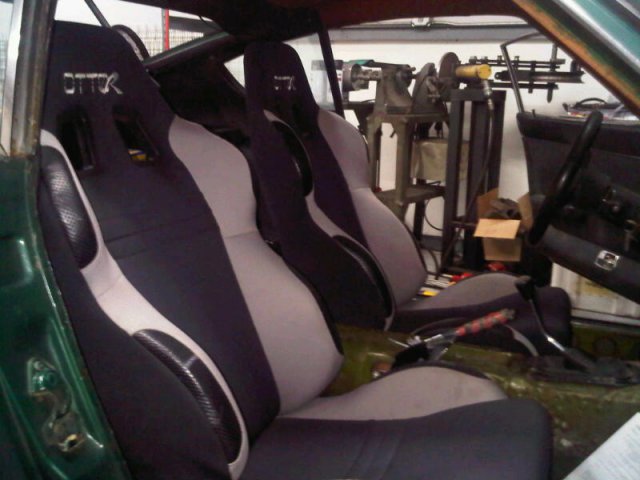

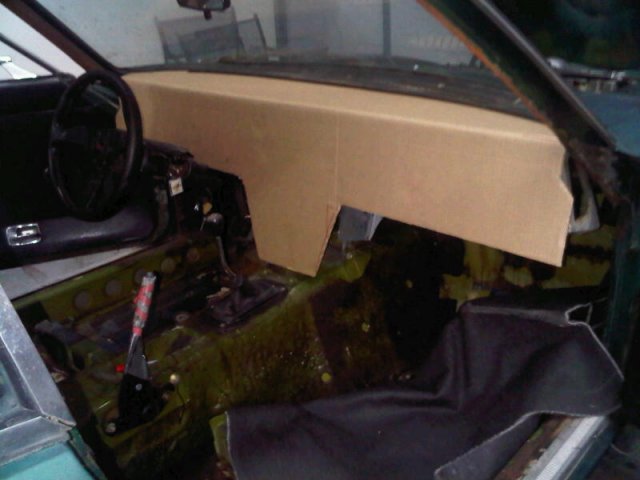

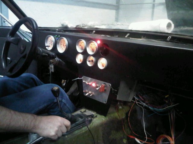

Packrats destroyed the interior and wiring. There was no going back.. Mockup, highly detailed aerospace cardboard... took about 15 minutes.. Trial fitting, same day. Went for an aircraft style look. Is what it is ... Mine forever more at this point.
