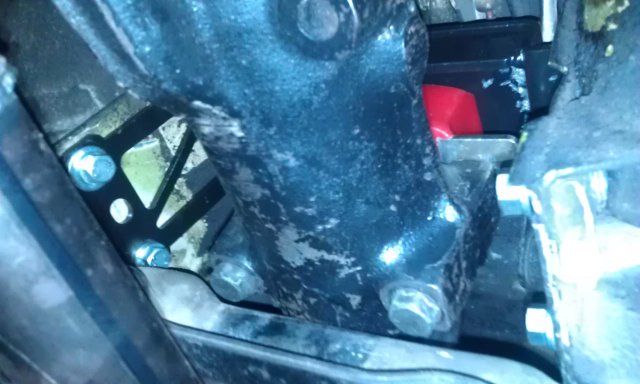

  4. Plus I was running the Arizona Z-car mount before which has stock geometry according to Dave. Now using the R/T Mount which is just a tad lower on the diffy nose. Vibration unchanged.
  5. Sure doesn't look like much mis-alignment. I know the R/T mount with Energy bushing puts the nose of the D/S down a little lower. but it wasn't this way with the old R180. I will check.

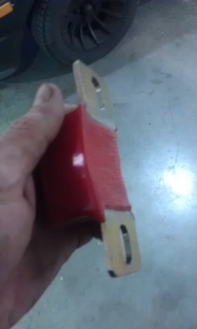

  16. Aaaah Geez that was a job. Installed my Technoversions RT Diff Mount and Energy (interlocking) mount. Beautiful product, superb response to all my questions from the proprietor. My 240 was about .125" more narrow than the top part of this mount so the install took a lot lot lot of BEATING to get that sucker in. Nothing more than sheer will and crashing hammer blows got all the holes lined up. I should have just taken it out and beat on the tunnel~ but once I got it up in there I couldn't get it out and I was in a hurry and I am a hack anyways, so. I also chose to relieve a little of the rubber from the mount to fit the shape of the thing a little better: Based on my historical averave, this will probably turn out to be a big mistake. But for now... its done. New driveshaft comes back tomorrow and I can finally burn that solid mount into a pile of molten...
