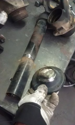

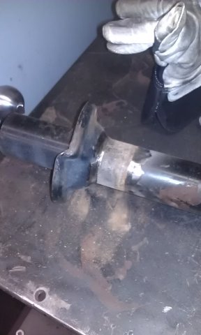

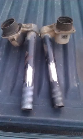

Did my research, gathering my parts and today began the coilover buildup. So far I have rear strut tubes, rear ZX disks, 27 spline stubs, Toyota 12w fronts. Still looking for bare front tubes so I can build and swap. Ground Control 300f/250r will be here Tuesday, Tokicos per the stickies and some half-ass camber fixers. Die grinder around the weld pile. Hammer time Slip n slide Not even time to drink beer on this round.
