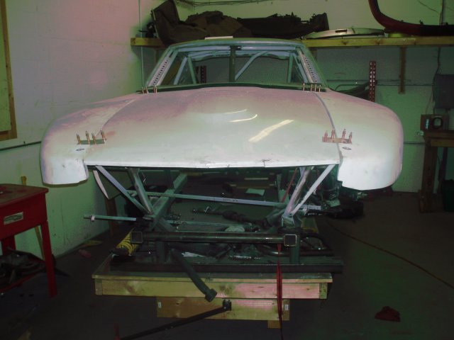

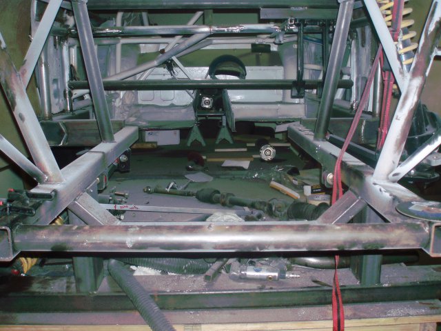

  14. Here is a few pics from the strut tower and bracing. I cleaned most of the dust for you guys!! The motor will be slightly right of center for "alignment " purposes... not weight distribution.( LOL)
  15. If you find an engine and tranny together let me know, I'm looking for a VQ35 and a bell housing from an automatic!! If I find anything in my search I'll let you know. Chris four zero 7 4 six three zero 3 one two
  16. Actually thats a lot of fiberglass dust from last weekends attempts at the front airdam!! LOL

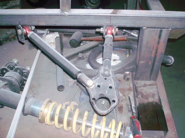

  17. I hope this is the general idea?!Sway bar mount is not drilled yet, but will be in center. Not trying to highjack.

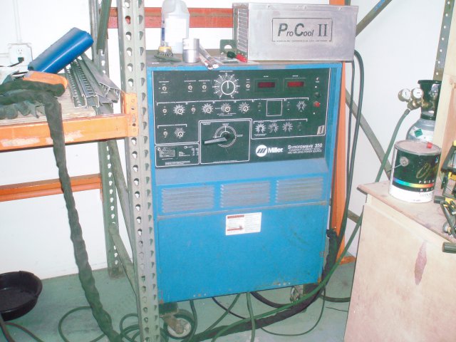

  21. Scored this week!! Miller Syncrowave 350 TIG unit, cooler, pedal, leads everything!! 1600 Bucks!!!!!!!!!!!!! Just pretty excited!!! I have only been looking for 8 months now!
