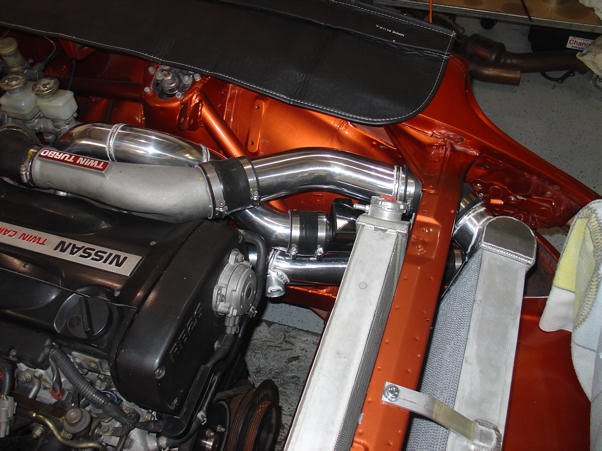

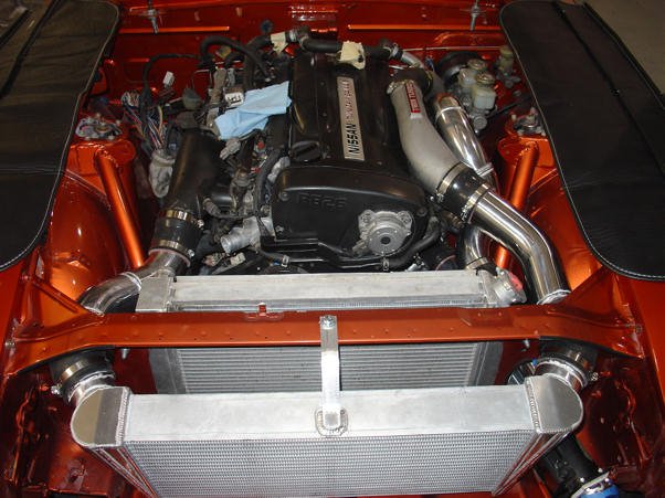

From earlier: Ken, Here is a recent side shot when I had to move it out of the garage and back in tonight. For the core dimensions... I'll have to fish those up. Maybe next week. It is a fairly big core, I think 24 inch x 11 x 2.75. I'm guessing a bit though. -Bob
It is a PWR core with custom end tanks. Their selection can be seen here: http://www.pwr-performance.com/intercooler.htm I can't find it on the site, but one of the reasons I chose them was the different design of the tubes themselves - it is thicker on the leading edges,(better dent/ding protection), and thinner in the middle for better heat transfer. I have a limited airflow to deal with, so a bar and plate were not a strong consideration as they would have restricted airflow even more. I was originally looking at a delta fin setup similar to the no longer available Apex'i intercooler cores. There are some Chinese knock-off's that I wasn't really enamored with. I almost found these by luck. They gave me about 30% off the list price of the core size I was looking at,(I had originally inquired about one of their sale item intercoolers). They are an Australian company which is now expanding to the US. PWR apparently outfits several OEM's in Australia - or so they say. Long answer to a short question. -Bob

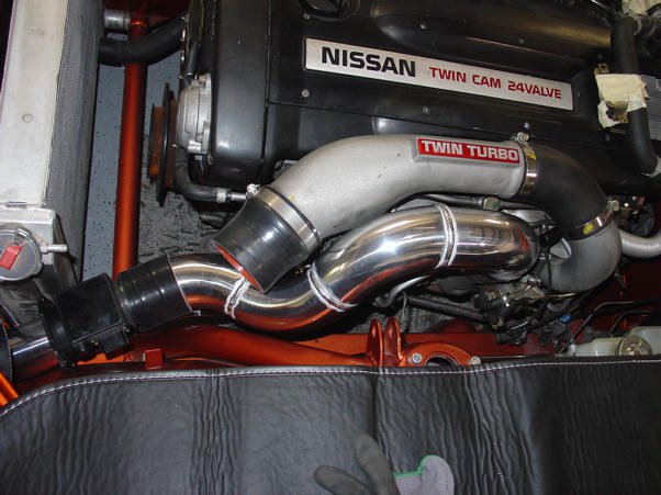

Alright, finally back online consistently again. Some shots from my "trip". First, Walker Morgan of Morgan Performance Fabrication did all the work and I'll say it again - he went out of his way and was a complete professional. I can't recommend him enough. The work was top notch and I need to thank his wife for the late nights he spent to accomodate my very short schedule. You can ask for better customer service than that. Ok, just a few shots. I'm still working on the intakes. Yes, I'm keeping the MAF's. Save your comments on how ditching them would be easier - I want them and will keep them for now. I can always remove them later. I now have the K&N filters,(from a snowmobile!) and the front brace bracket for the lower intake tube. Those pictures will be later. Enjoy. -Bob

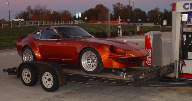

Late last night I dropped the car off at Morgan Performance Fabrication in Birmingham, AL for some intercooler/intake fabrication. If your nearby, please give Walker a call and swing by the shop. I'll be picking it up next Wednesday. He'll be in the shop Monday and Tuesday working on it - I'm sure he'd welcome the viewing. I had to lift his jaw off the floor when we rolled it in the shop - its worth the trip. Here is his website: http://mpfab.com/ Was recommended to him through James T. Anyways - this trip cross country is killing me - I'm ready to be in Texas. And James - sorry about not stopping by in Anderson - I rolled past Anderson at about 8pm at night on my way down to Alabama. Walker met me about 10pm at night - talk about a stand up guy. No pictures until next Wed... -Bob

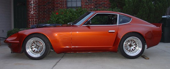

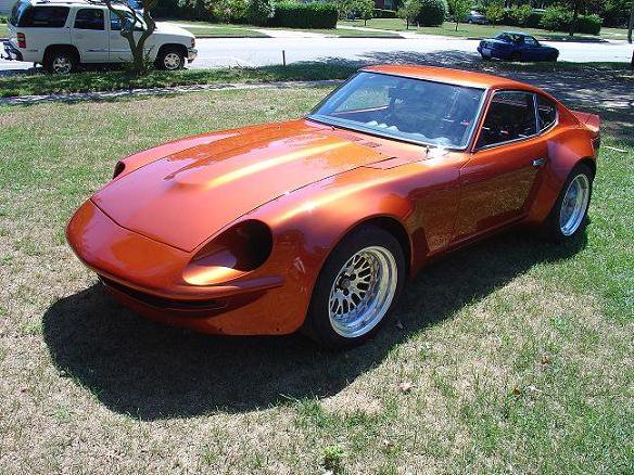

I don't have any straight side shots. The next closest besides what is in the first post are these two from the front,(the rear is in the first post): If you want a particular shot, I'll see what I can do, but with my trip starting tomorrow, it may be a month or longer before you can see it. -Bob

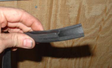

So the camera is back and I shot the remaining ones. The more I look at them, the more I think that the one with the round top is the top of the rear hatch and the two narrow ones,(not shown in these two shots but is just to the top and right of the round topped seal in the first post), are the left and right side. It is this other foam one I don't know. As you can see in the second shot - it has a section trimmed on one side. I have two of these.

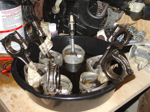

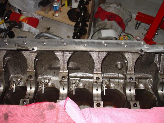

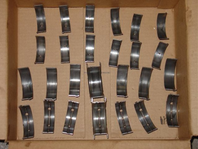

Well, some work on the engine tonight. Lots of grease, carb cleaner, and lint free rags. Pistons are now soaking overnight to get the last of the gummy crap off. #6 piston was esp. bad with cacked on crap - no surprise considering how the coolant flows, etc.. Should have the engine back together tomorrow evening - to be in the car on Monday. That's the plan anyways....you know how those go. Took a shot of the the bearings. The Rod bearings are on the top,(with the top bearing to the top of the photo), and the main bearings on the bottom. Right side = front of motor. What I don't have a shot of is the back side of the thrust bearing. It shows how even on a 12k mile motor, the thrust bearing will get worn out when you have to start the car with the clutch in,(was showing copper). Also included is a shot of the new dipstick hole. Had to make sure it would work with the new oil pan - it does. Did my best to set the level to where it should be. It's all a guess anyways. Any ideas for plugging the old hole? That's it for tonight.
Well, What I know I have: Door welting and weatherstripping,(the one piece set), rear 1/4 window inner rubber and outer frame foam for each side, rear hatch window rubber, front window rubber, rear hatch inner foam seal,(the main opening), cowl-hood seal , bottom of door seals, and that's all I'm sure of. The rest are in the picture above. I'm sure the one with the rounded part is for the outer hatch seal,(above the inner foam one), but it isn't long enough to stretch the entire distance - so I'm assuming there is two or three parts? Maybe the one I have is a left and a right which needs to be cut - however it isn't that long...(I checked). My wife took the camera tonight so I can't take any photos tonight. Most of tonight will be spent re-assembling the RB26, not on weatherstripping... It appears that I have a seal which goes under the fender maybe? I forget which one that was - but I thought it was rubber,(I don't have a rubber one like that). I also have some smaller ones of which I have identified all but one. Maybe in time I'll figure this one out... -Bob
