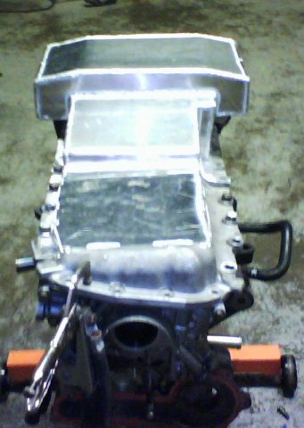

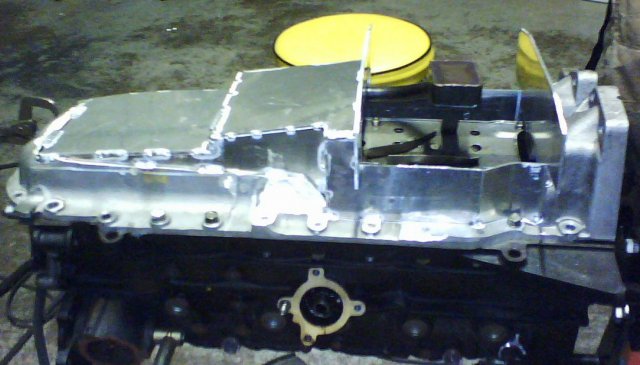

  1. The local Porsche club still runs on Cabiness every month - I just signed on to be their chief driving instructor for next year. We have a whole new group of folks getting the ball rolling and have really organized it well - a welcome change for the old guard who have kept things running for so long w/no new influx of blood. Anyways, the pan itself is completed - I now have to pull it back off and mock up the baffles, then put it back on. Its a work of art - the guy who worked with me on the pan is a good welder,(been doing it for the past 6 years every day). I did most of the cutting/trimming and he tacked it in place then welded it all. Next step, attach the G-Force tranny to the new bellhousing and block and drop it in the car to check clearance/etc... That should be next weekend. I'm really trying to keep progress on this... -Bob PS-the pictures are with my cellphone, so the resolution isn't that great.

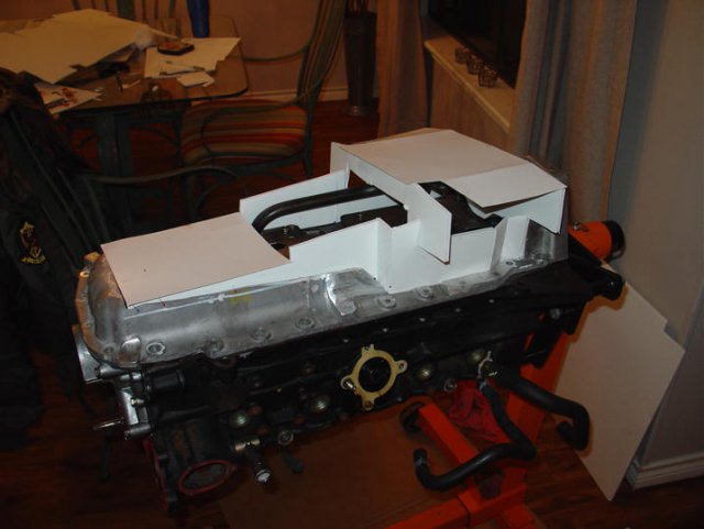

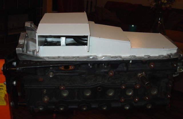

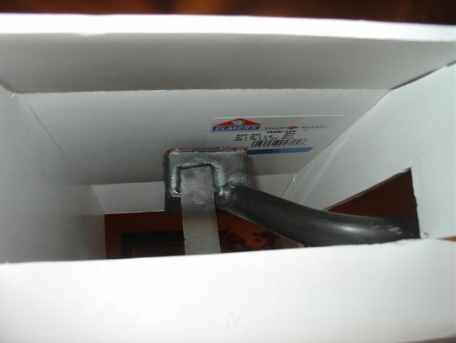

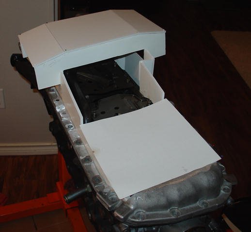

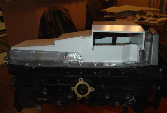

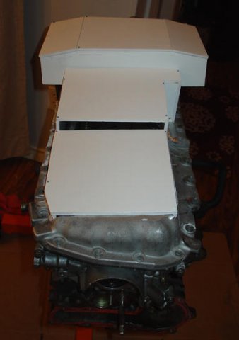

  4. Ok, oil pan issues. I posted about my previous concerns about my intended hard use and the thin oil pan. In addition, with many RB Z cars on the track having oiling issues, I wanted to re-design my setup. First, there are a few things I mandated that I include. One - the windage trays that bolt to the bottom of the main bearing girdle had to stay. Second, I wanted extra capacity. And third - overkill thickness on the aluminum. The cardboard paper I used as a mockup is the thickness of what I will be using. As you can see in one of the pictures, (and is shown earlier in this thread), I have a custom pickup - and I was mocking up the pan to match this pickup. Once the pan is actually fabricated, I'll install the baffling and trap-doors. There are two reasons generally speaking, why RB26 motors have oiling issues on the track. The first is insufficient oil in the pan - leading to a complete loss of oil pressure. Mark with his Silver Z showed this in his video from Texas World Speedway - with the sudden fall in pressure under some braking and right hand turns. He has since re-worked the oil pan and increased the amount of oil in the pan to help deal with this. The second issue is aeration of the oil. There is a lot of oil moving around the engine, and with the crank spinning around at 6-8k rpm, it tends to whip it up in a froth - which leads to air in the oil, which in turn, gets sucked up the pickup - into the oil pump where that bubble now creates stress on the oil pump gearators and slowly lowers the output of the pump,(typically seen by a falling oil pressure). I'll be honest - I'm not 100% sure exactly what leads to both of these problems beyond insufficient and air in the oil in the bottom of the pan. I used to believe that the oil pooled in the head - but have since found many examples of RB's with high volume pumps, no extra restrictors anywhere in the motor - and they are operating fine. If you take a close look at the tray which bolts into the bottom of the RB26 stock oil pan casting - you will notice it has two layers, the first of which is very similar to the "windage tray's",(as I call them), and then another flat piece beneath it with a few holes. This bolt-in tray serves to help the oil settle down and remove the excess air in the oil before it gets to the bottom of the sump. So bottom line - I won't be using the external cylinder head drain, but will attempt to fabricate another "windage" type tray to help route the oil down to the bottom of the sump, i.e. slow it down and allow the air to get out of the oil. I.E. I'm trying to keep it as much like stock as I can within my limitations of a rear sump. If I were drag racing this car, these issues might not even pop up, and for sure daily driving would matter either. But high G-forces in a 25 min session will expose any design flaws in my setup. You can see I did a lot of the cutting and fabrication on my own and will only have the shop do the actual cutting and welding. Otherwise this would have been an outrageously expensive setup. -Bob

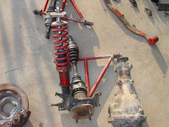

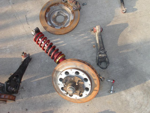

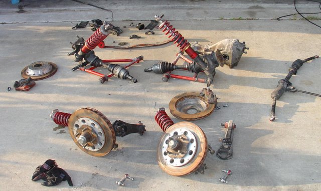

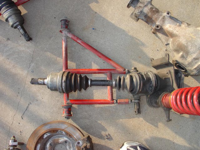

  5. Ok, Long overdue work was finally accomplished and here is the long overdue update. All the suspension under the car had lots of "gunk" on it from the layer of grease followed by 2 years in the body shop with lots of sanding - lots and lots of junk on all the parts. In addition, as you will see in the pictures, there is some corrosion on parts, etc.. and before I take this on the track, I need to take a look at bolts/nuts/etc... In my post after this, I'll put the oil pan update. Of note: ALL of the bolts holding the halfshafts to the outer stub axle were loose. The previous owner had warned me that I would need to tighten them before every event - now I see why. Again, EVERY one was loose. Sure, they have loc-nuts on each one, but some you could spin freely,(to be more clear, the bolt and nut combo spun freely - but the nut was still held on tightly). I need to look into a safety wire situation when I put this back together. So something to check for those of you who might be running the CV setup. To answer the questions about who made the suspension, where can you get it, etc... It is a shop in Atlanta - I can get the info by digging some. They were custom made, as were the adapters for the 300zx brake calipers,(3/8" thick steel). The rear bracket includes an adapter for the wilwood parking brake caliper,(that is on the "rear" portion). This was designed to be a suspension setup for a GT-2 racecar. The swaybars are Speedway engineering - and are fully custom if you want to duplicate them. Do-able, but expect some welding/etc... and it won't work with a stock rear fuel tank. The front is eaiser, but expect to reinforce the frame rails up front,(as you should do with any aftermarket large sway bar) If you have more questions, just ask and I'll see what I can do. -Bob
