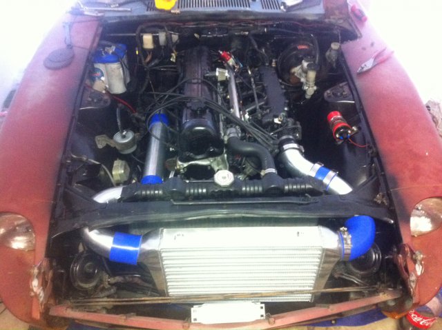

The reason I didnt go with a same side inlet outlet is because I didnt want to cut a hole in the core support, and the reason I went under the motor vice across the front of the engine bay was so I could retain the stock fan. (for now!)This is what I have so far. I havent made mounts for the intercooler or hooked up the piping by the starter yet. I also have to pull it all back off to clean the metal shavings. This is a pre mock up to say the least but it should be ready for the maiden voyage soon.
