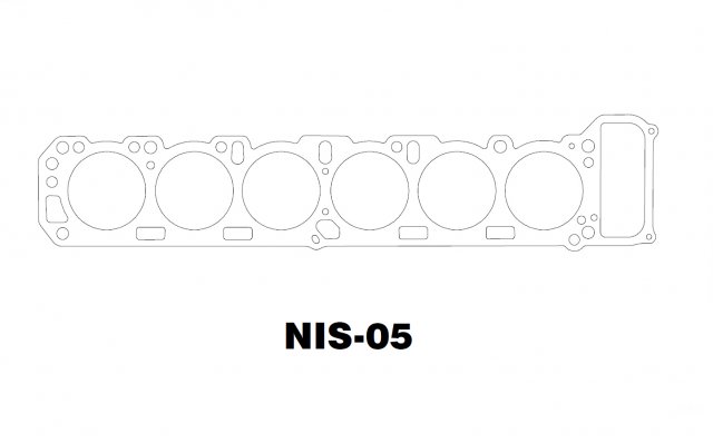

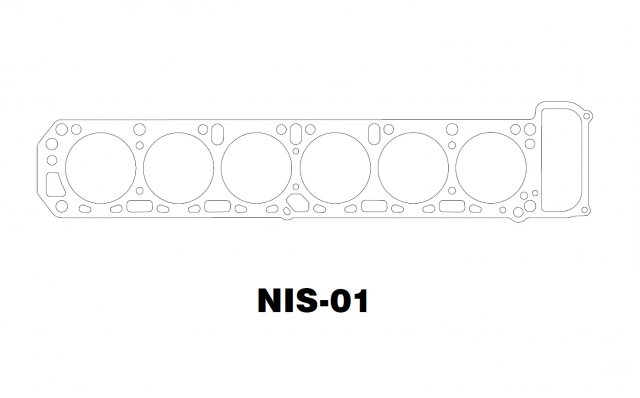

  13. Hussey makes two L6 copper gaskets in basically whatever thickness you want. See attached images. NIS-01 is the N42 style NIS-05 is the P79 style with some trimming to contour the cylinders The message I got from JR at GMT Racing (he worked on the Bob Sharp team), is pretty much what Tony is saying. Get as much into the head as possible, and then restrict the flow on the outlet. A flow restriction at the thermostat outlet is where they did it. 3/4" to be exact (from JRs memory). They ran a stock Nissan N42 gasket with an E31 head. They cut grooves in the block for copper wire just outside the gasket fire ring. They never blew a gasket running over 13.5:1 CR. Pete

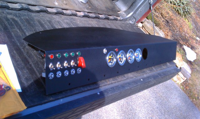

  14. This is the tach I am using: It clamps to the steering column. I decided to use an external tach to keep the dash height low for better visability. I also wanted a 5" tach. I sprayed the dash with bedliner. Pete
  15. Here is my dash so far. Each circuit has a resetable circuit breaker. The tach is a column mount that sits in the blank space between the switches and the gauges. Switches are: IGN Pump 1 Pump 2 Wipers Fan Lamp near oil pressure gauge is low pressure warning.
