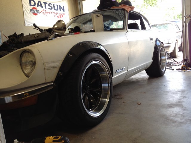

Well the Z is back from the bodyshop, and the result is... satisfactory. Some of the gaps are still a touch wonky, but at least the front end is straight now! I'll probably spend some more time, or have him do a little extra tweaking before the paint goes on in the next few months. BUT, all 4 wheels/tires and flares are on, and boy does this booger stick! Sadly I had to dial the caster back to 3.8 to get everything to clear properly, but oh well. I'll get some pictures taken when I get her cleaned up more. So, on the tuning front I've made some progress. I finally realized why my idle VE numbers were so low, and my high KPA's so high compared to everyone elses. Multiply map! I've had mine set to "don't" or off this whole time, no wonder I've had such a terrible time getting the car to idle properly, and this is probably why I've been getting such mediocre gas mileage. With multiply map off, 1% VE change equates to about a 12% change in pulsewidth! Once you run the equation you can see how it gives me great tunability in the upper ranges, but honestly they're less sensitive to change anyway, so turning multiply map back on and retuning will give me a much smoother idle and cruise. -
