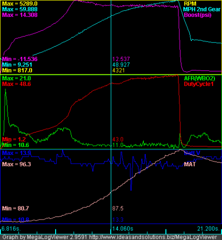

93 octane, kameari 1mm head gasket, so compression should be very close to stock. The power loss seems related to boost pressure, the more boost, the worse it is. Under 10psi it doesn't seem to happen. I'm not sure it's spark blow out either. Last night I was helping a friend with his subaru, we loaded a mail order tune and adjusted the boost, at 18psi it would 'skip' every now and then at wide open, at 16 psi this didn't happen. AFR was alright on both, I believe this was spark blowout, that's not like what I'm feeling. I wish there was a better way of describing it, reminds me of fouling a sparkplug on my snowmobile, like it drops a cylinder or 2.

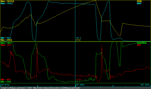

It feels like it might be misfiring, and sometimes it seems to run poorly after a WOT pull, you can smell unburnt fuel when it does run poorly. The odd thing is that it doesn't seem to show up on the wideband trace. It doesn't do this unless you go past 4500-4600, if you stay below, it runs fantastic. This feels like a large unnatural power loss, not like the engine just running out of steam. The thing that really bothers me the most, why does the power just disappear but the datalog looks perfect? I have datalogs of it breaking up at 4500, then continuing to run like crap for 30 seconds more, the afr's on the log look fine, the only telltale sign is that it took more throttle to keep the car going than normal. Spark advance is around 40 degrees in the low load cruise areas, at 12psi it's closer to 20. Megasquirt is controlling spark, it's set up firing the coil directly. I didn't put the head together, so I'll check and make sure the springs are all there. Could a set of worn or poorly maintained hydraulic lifters/lash adjusters cause odd problems like this? Compare this to the 1st pic, notice that it doesn't fall off. This one went to 5500 easily.
Engine: fresh L28ET lower end, stock p90a(unknown miles), stock t3, 750cc injectors, MS2, walbro 255, AEM regulator, evo 8 IC, 2.5" downpipe, 3" exhaust, optical dizzy, new NGK wires, new cap/rotor, new plugs @.040" gap, and an MSD blaster 2 coil. Here is a burst datalog of it happening in 3rd. Because the AFR looks perfect and the power loss is smooth, I'm thinking it's a mechanical problem and not a tune problem. Valve float or hydraulic lifter problems maybe? It might not be entirely clear from the picture, but the car did not have the power to go past 5300. 2011-10-08_15.58.54.zip
