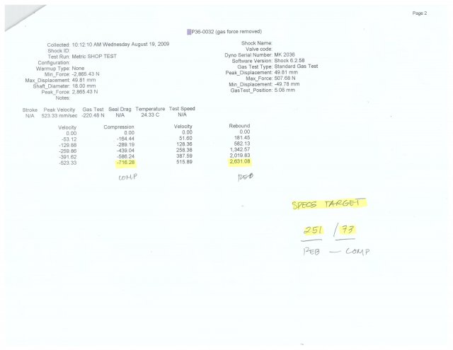

Yeah, those numbers sound pretty close to what I've found elsewhere. This is some dyno data I found, the pic is huge. The revalve is 100/300. My main worry is that I'd be over damping the 200lb springs to the point of unnecessary harshness or packing down over bumpy sections of road. I doubt I'd be able to do anything useful with the adjustability of the tokicos, my time would be better spent learning to drive instead of fiddling with everything. -

The strut thread has about 14 conversations, no clear topic or direction, but reading through it several times, it seems like most guys are running revalved bilsteins with 300-350lb/in springs on dedicated racecars. I've not found a useful dyno chart of the factory valving, I found one, but the velocity increments are pretty huge. I can't find a single dyno for an illumina (full length or sectioned). There was a comparison of various civic shocks posted in that thread, it appears that the bilsteins(for a civic) are very similar to single adjustable konis on 2. Are these valvings even remotely similar to a Z? I might just go with the mr2 illuminas and sectioned struts if nobody has any input on using the factory valved bilsteins. They are known to work pretty well already. -
