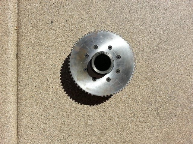

So i messed with this a bit more today. As long as the engine turns counter clockwise then its correct. The pickup lands on the 12 tooth at TDC, so its 6 degrees advanced. Anyone know if the engine rotates counter clockwise? If it rotates clockwise its 180 degrees off which might be the problem.
Can someone tell me if this trigger wheel is on the balancer correctly? Its not for megasquirt, its off electromotive which uses a 60-2 wheel, but I would feel the idea is the same. Pickup is supposed to be off the 11 or 12 tooth for TDC from the gap. My problem is that nothing is marked for me to know where TDC is so I can tell if this wheel got put on right, in relation to the woodruff key... Does the woodruff key indicate where TDC is in relation to Compression/Exhaust stroke?
